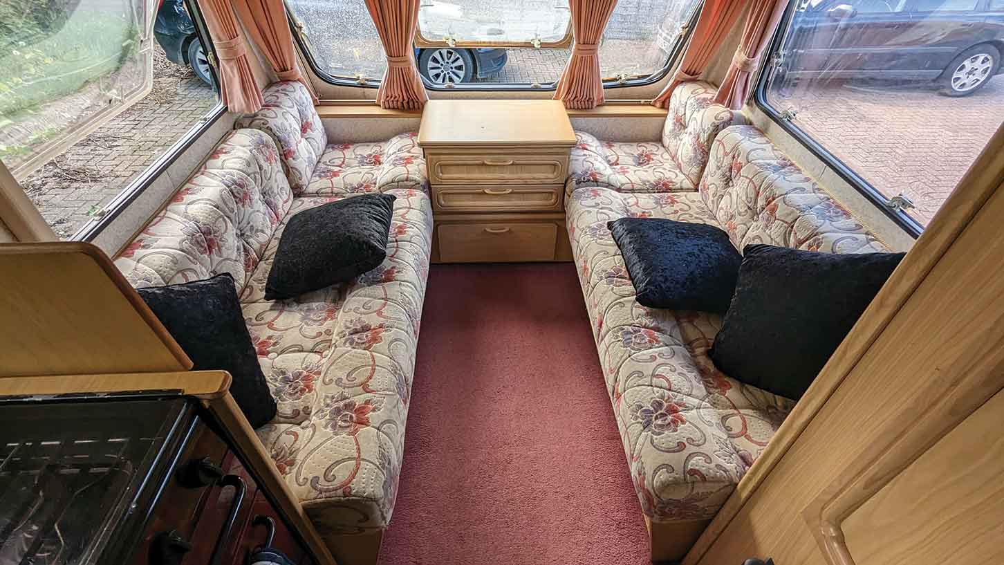

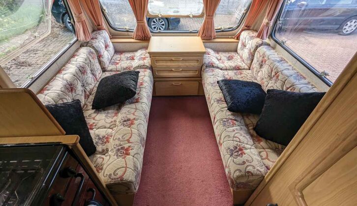

The interiors can really date even the best used caravans and we were keen to try to cheer Penny up a bit.

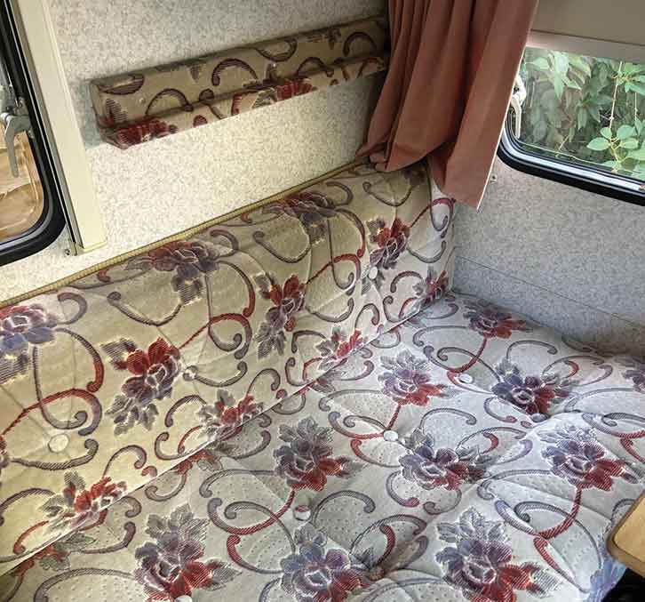

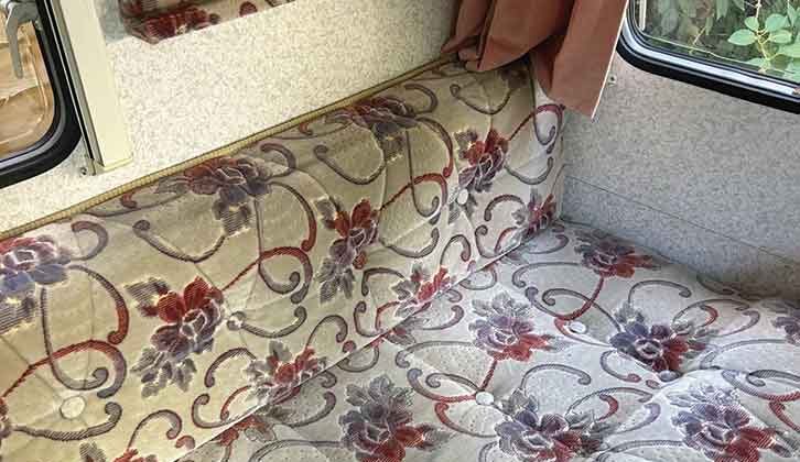

The lounge before the work was carried out
Before: a bit too pink and busy for modern tastes

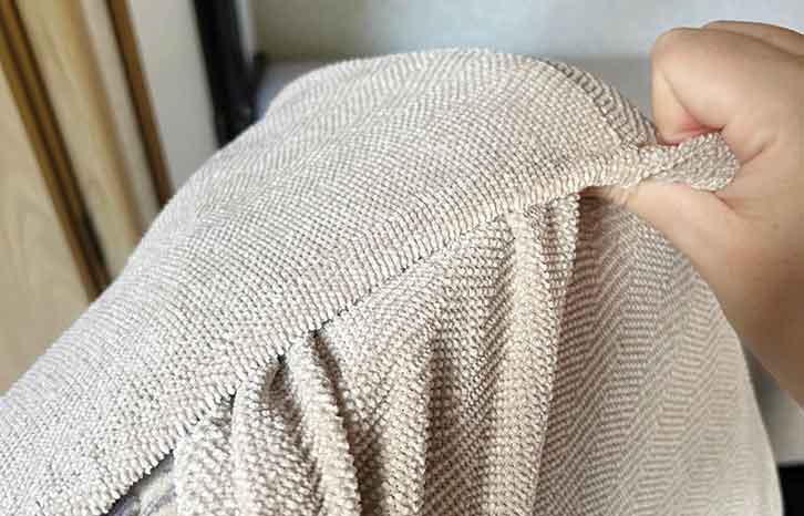

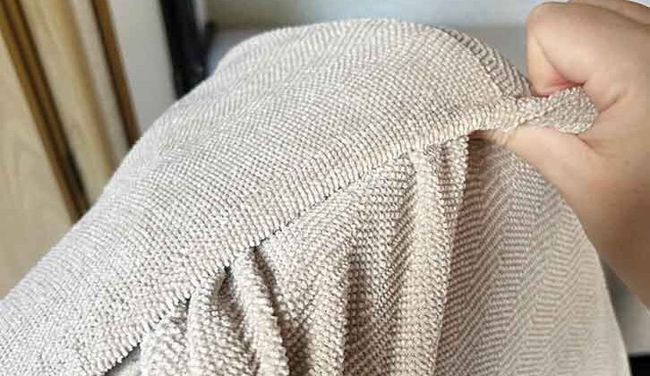

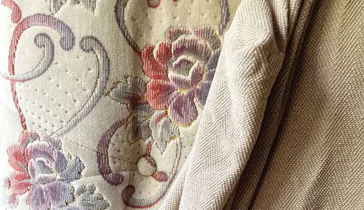

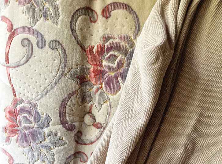

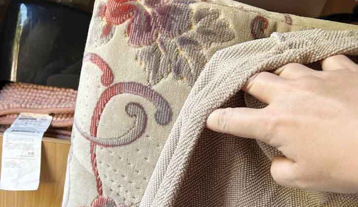

My partner, Jen, mentioned that a lot of caravanners she has seen online have modernised their caravan interiors using stretch covers. These are essentially just a ‘bag’ of fabric, with a hoop of elastic sewn into the back. To fit them, you grab the cushion you want to wrap and pull the cover over the top.
The elastic ensures that the cover is pulled taut over the cushion, to give a smart effect of a freshly covered seat.
You don’t need to be any good at upholstery, or even have a lot of time at your disposal to update things.
Fitting the covers
Time to get the covers on, fingers crossed they all fit
The covers themselves are actually designed for domestic sofas and armchairs, but given that customers buy one cover for each cushion, rather than a set per chair or sofa, it is a simple matter of measuring up and seeing what you can find that most closely matches your caravan’s configuration.

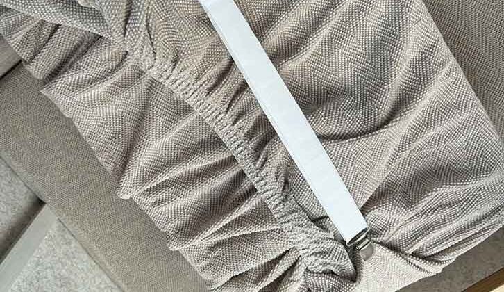

A cinch clip keeping the covers in place
On the smaller cushions where the covers were too large, we used elasticated cinch clips to keep them in place

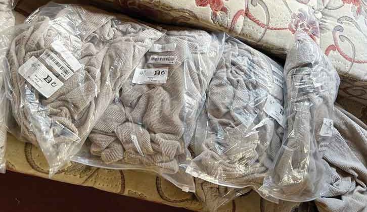

The new covers arriving
Package arrived, and they don’t look too impressive – yet

We checked that everything we ordered had arrived, and that the covers all matched. Once we were happy we had all we needed, we set about fitting. Each cushion took around 10 minutes to fit roughly, but at least twice that time was spent pulling the covers taut, folding in excess fabric and generally improving the fit.

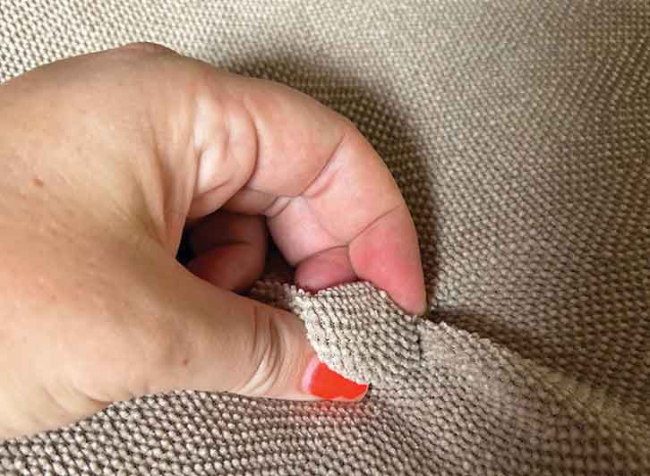

The Bailey cushions have a button-back design, and simply covering these up looks fine. But an even better bet is to pick up some clear elastic hair bands, which are easily found online. The smallest bands are the ones you want.
A tiny elastic hair band in the palm of a hand
Tiny elastic hair bands came in handy

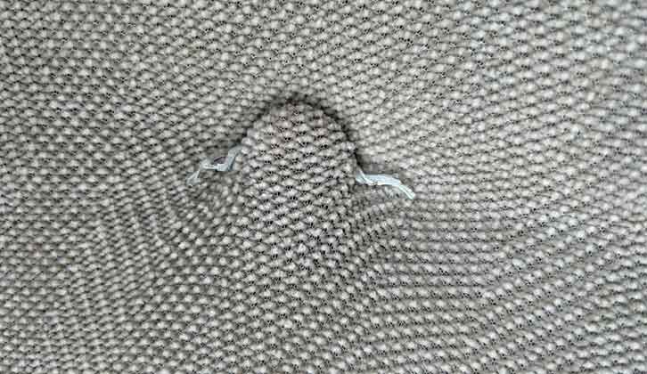

Once you have the bands, find a button on the cushion, pinch the cover over it and slip on the band. The elastic band will pull the cushion fabric tight over the button and give the cushions a real factory finish.
These will periodically pull away and need replacing, but with packs of 1000 bands giving you change from a fiver, it’s not a huge concern. It is a bit fiddly, but the effect is stunning.
The new-look button
A few twists of the hair band and voilà, the new-look button

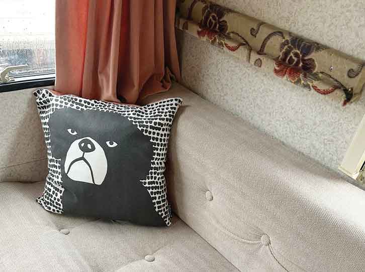

The finishing touch was to pick up some scatter cushions. Given that the new seat covers were rather plain, we opted for some fun ones that we found on offer at Sainsbury’s, along with a couple of cushions that we don’t use indoors.

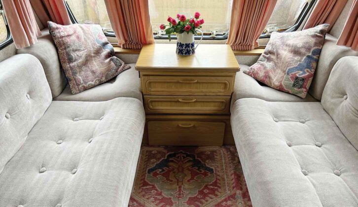

With the cushions in place, the first part of Penny’s interior makeover was complete.
Jen decided that she liked the pink curtains, so they’ve simply been put through a cool wash to freshen them up.
The rear lounge
The rear lounge also gets a fresh new look
