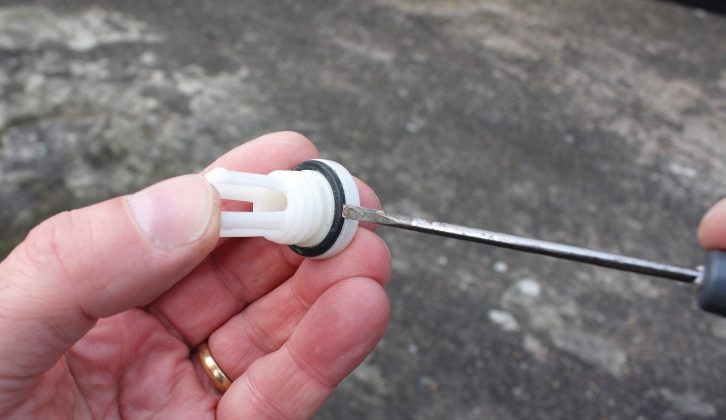

Starting inside the caravan, open at least one of the hot taps. Then, using the flathead screwdriver, remove the drain plug at the bottom-left corner of the Carver Cascade unit when viewed from outside the caravan. At the top-left corner, turn the Fast Drain valve through 90˚ (until the screwdriver slot is horizontal).

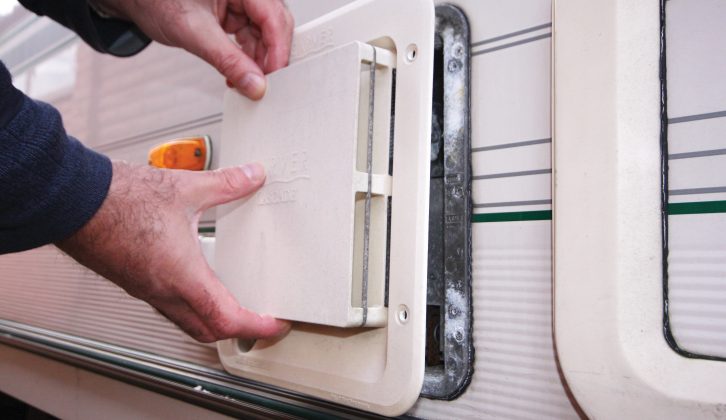

Once the water has drained, undo the four crosshead screws that hold the external cover in place. Once they have been removed, the cover can just be taken away. If there is any resistance, it is likely that it is being gripped by a bit of wayward sealant from when the unit was first installed.

Before you return the drain plug to its place, check that the rubber ‘O’ ring on it is in good condition. If not, it will need replacing because it is likely to allow water to leak out of the heater. New ones are still available.
