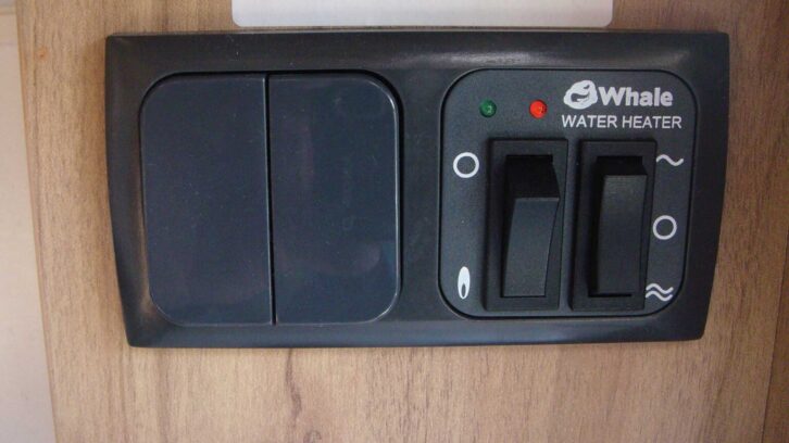

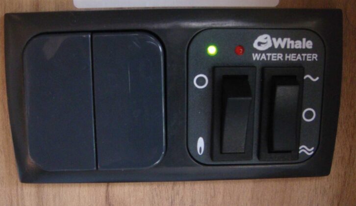

I’d reached for my caravan tool kit and the fix seemed to be OK as it worked for all of the six months when we used the van during the summer months. However, the importance of pre-tour checks was highlighted as unfortunately, this time when I turned on the gas heater switch, I was confronted with a solid red warning light which I had never encountered before.
The red light on the Whale hot water heater switch
I looked in the owner’s handbook (which came with my van) under the section for the Whale gas and electric storage water heater. Beneath ‘Fault Finding’ it gave a list of possible causes according to the number of flashes of the red light. However, it showed nothing for a solid red light. As the HQ for Whale was in the next town, I thought I’d take the van over and see if they could help.

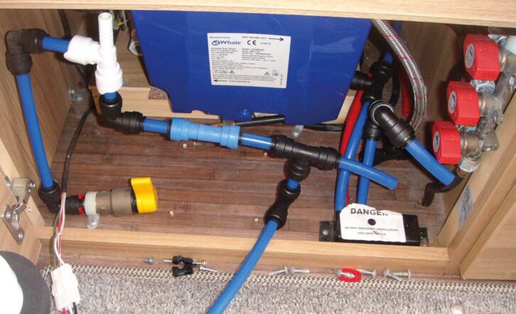

Having previously replaced the PCB, I wasn’t looking forward to removing it again – it meant draining the system, undoing the water pipe connections to the water heater and the water pump, and then removing them as they were blocking access in front of the water heater.
The front of the water heater being blocked off

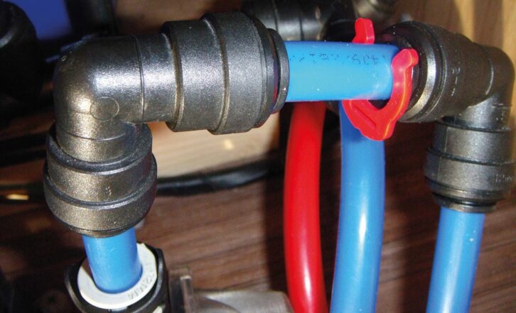

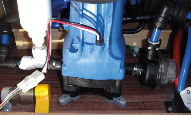

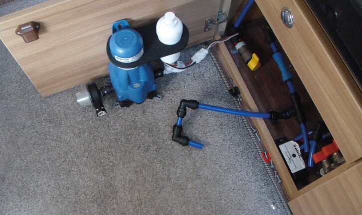

Once everything was drained, the plastic pipework was easily disconnected by pushing in the ends of the black pipe connectors with the supplied red plastic disc and then pulling the blue pipe out, while the Whale water pump is simply unscrewed from the floor rubber mounts.
Disconnecting the pipes

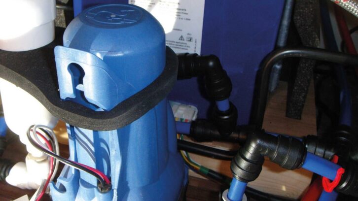

With the pump out, I could unscrew the filter attached to its side and remove the metal gauze to wash away any sediment that had accumulated during the past year.
Removing the metal pipe so any sediment can be washed away

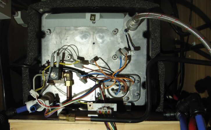

With the pump now out of the way, the blue plastic cover of the front of the water heater was exposed.
The exposed cover of the water heater

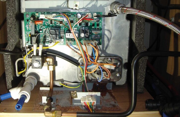

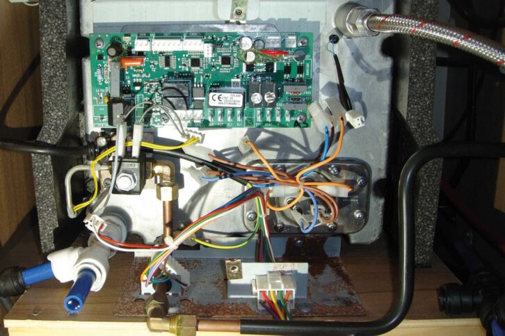

It is held on by two screws and when removed, revealed the PCB and the attached wiring.
The PCB and the attached wiring
When I did this the first time round I took a photo to remind me where all the connections were before I undid anything, so it would go back together correctly. The connectors are easily unclipped and I found that most will only fit back together one way. There were some that could have been inadvertently misplaced, so I marked these with a felt-pen to be doubly sure.

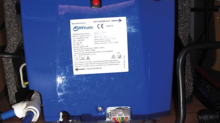

The PCB is fixed to the metal casing at the front of the water heater with four screws and can be removed without touching the gas connection (8).
The metal casing after the screws have been removed

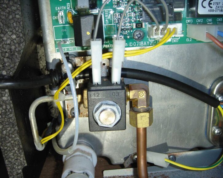

However, I did check if the gas solenoid valve was working by applying 12V to the two terminals and the clunking on and off showed that it was OK.
Checking the gas solenoid valve was working

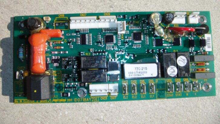

I emailed a photo of this PCB to Whale, who replied  saying that the replacement board that I had bought last year was not exactly the same as the one in the photo that I had taken of the original PCB before replacing it.
The original board
The original board

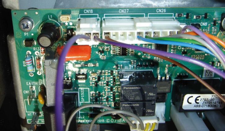

There was only a minor difference: the second PCB had an extra slot CN18 for a reset switch and this was the reason why the control panel was showing the solid red fault light.
The replacement board

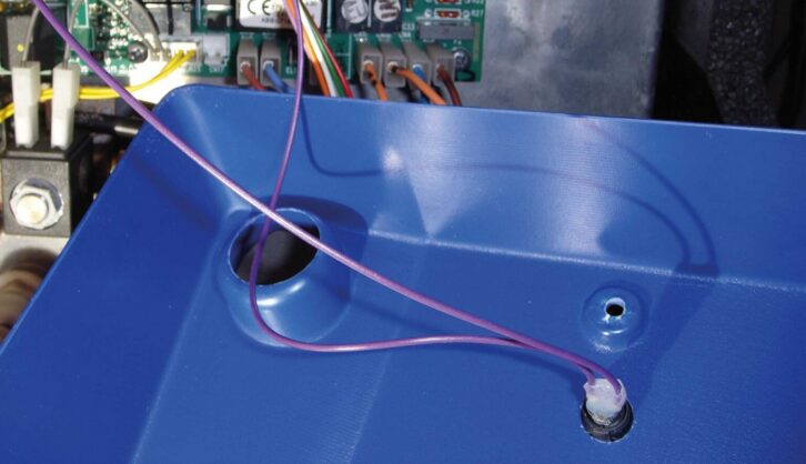

Whale kindly checked the rest of the PCB, confirmed it was working and supplied me with a reset button, which I mounted on the front plastic cover by drilling a 15mm hole.
The wiring for the reset button
Reassured that the electronics were working and relieved at not having to fork out for another expensive printed circuit board, I began to reassemble everything back together again.
The wiring for the reset button was now connected to the spare slot in the PCB. Once I was sure that I had all the other electrical connections in the right place, by constantly referring back to the original layout photos, it was a relief to screw on the front cover and see the big red reset button sitting proudly in the centre of the blue panel!

Next job was to reinstall the water pipes, which simply push into the plastic connectors. The first time round I hadn’t pushed them all the way in and as a result several of them had leaked when I turned the water on. This time I made sure they were fully inserted before screwing down the water pump to the floor and then finally connecting it up with the electrical push-on connector.

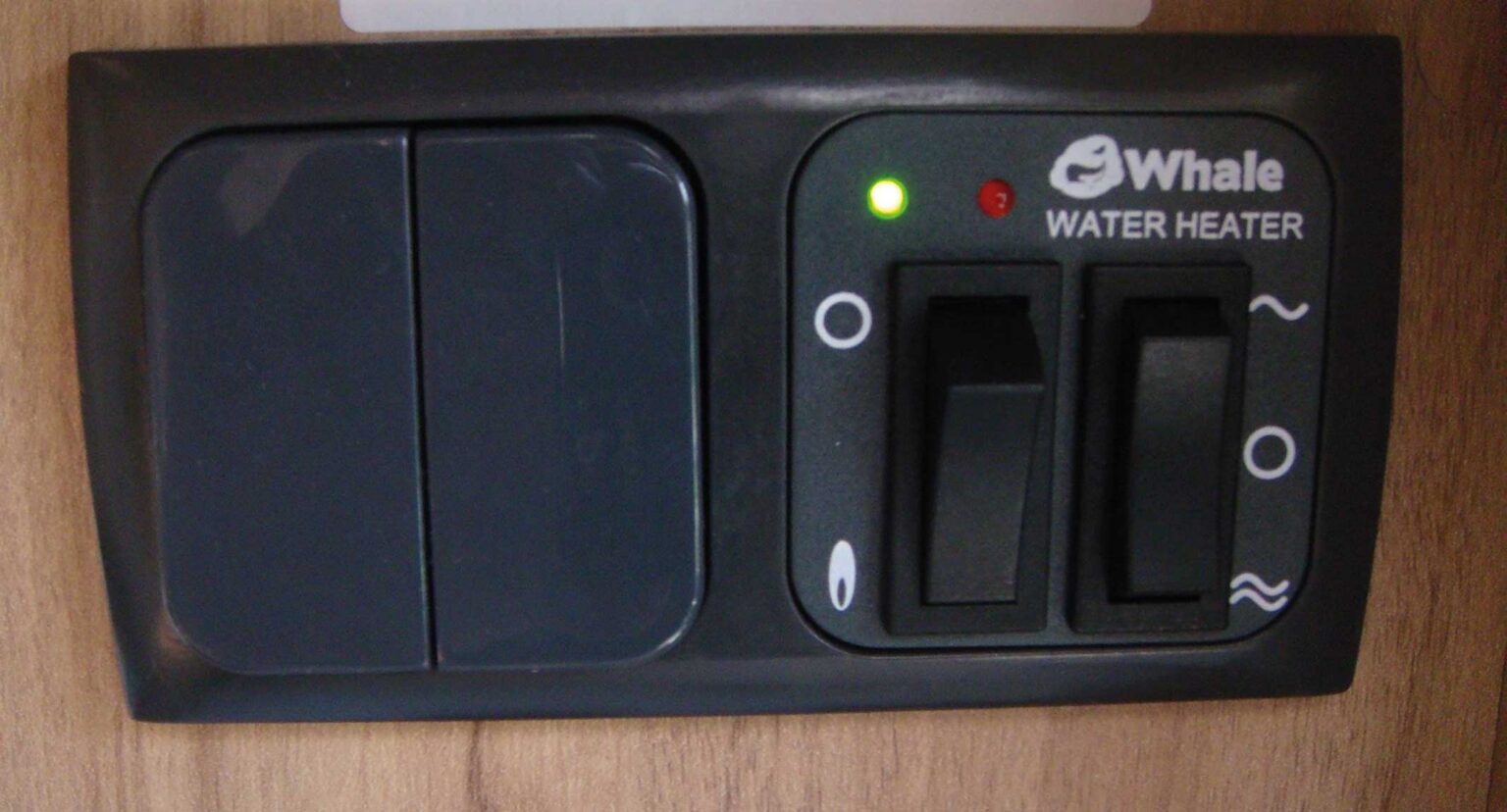

With a water source connected, the pump was switched on (this time with no leaks); then, with the gas tanks turned on, it was with some trepidation that I flicked the switch on the control panel. After a heart-stopping few moments I eventually heard to my relief the gas solenoid open with a clunk and then on came a green light to confirm that the gas had ignited and was heating the water.
