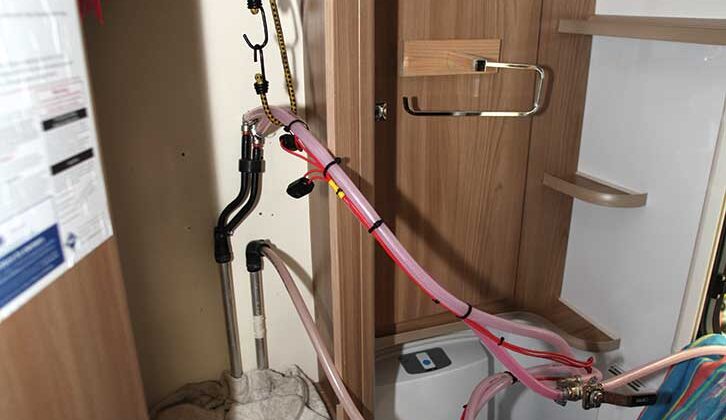

Alde wet boilers also vary in that they need a reservoir for their heating fluid. This container is usually located at the back of a wardrobe, and normally contains a magenta-coloured liquid.
This is a G13 glycol antifreeze solution and is the fluid that is heated and circulated through the pipes. These antifreeze properties ensure that it doesn’t have to be drained down in very cold weather, although it does need to be checked annually for strength/dilution, and changed every five years.
This fluid also contains inhibitors that slow the degradation of the pipes and internal surfaces in your caravan heating system. Changing your heating fluid is generally a job for the professionals, and will cost from £150 to £250, as it is quite involved.
However, experienced DIYers could attempt this job themselves, which brings the cost down to around £30 for the fluids, although it’s advisable to buy a pump, too. A basic pump costs from £10 and can be found on eBay. Video tutorials on YouTube demonstrate the process.
