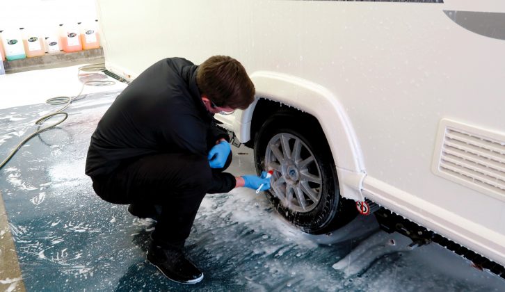

Finally, don’t forget the alloy wheels. A quick spray with Autoglym Instant Tyre Dressing will give your alloys that real showstopper look.
