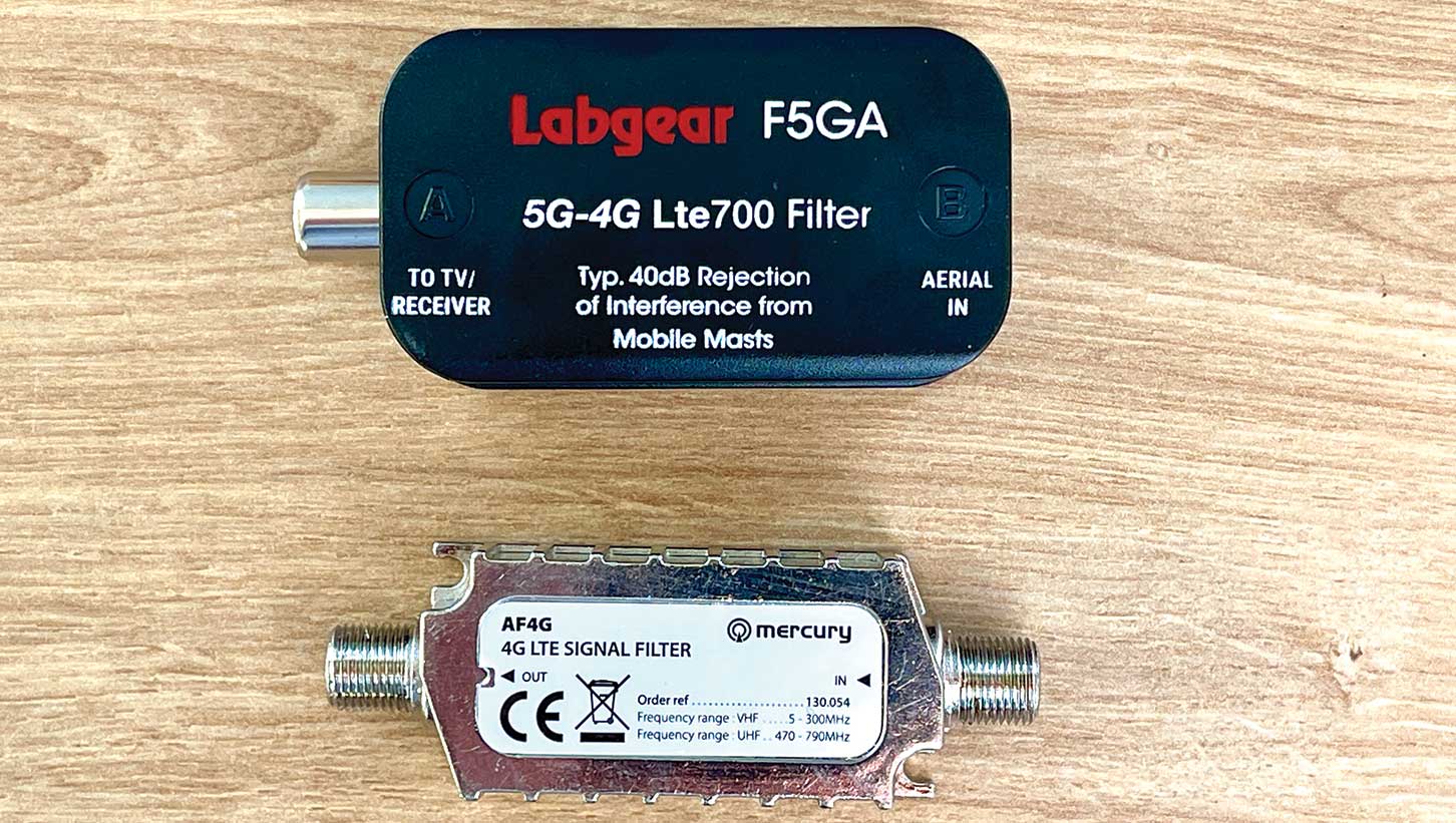

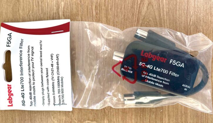

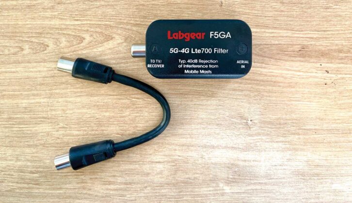

The filter out of its packaging
The 5G-4G LTE filter out of its packaging
Mobile phone and internet signals are all around us and can interfere with TV signals, especially if the TV signal is weak. I know that nowadays many people stream TV programmes via the internet rather than by using an antenna, and we recently upgraded our tourer to have caravan Wi-Fi, but we also still use the TV in the traditional manner too (if you do, see our picks for the best caravan TV aerial), and on occasions have seen the TV screen pixelate as the signal has seemingly ‘broken up’.

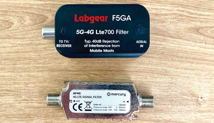

The 5G-4G LTE (top) and older 4G LTE filter
Having had this happen, I came across the filters and thought that it would be worth giving one a try. That’s when I got the 4G version. They’re cheap and are simple to fit.
As I explained above, it’s so long ago that I got the 4G version that by the time I thought about it again, I saw that there was a 5G-4G version, and that’s what I’ll be fitting here.

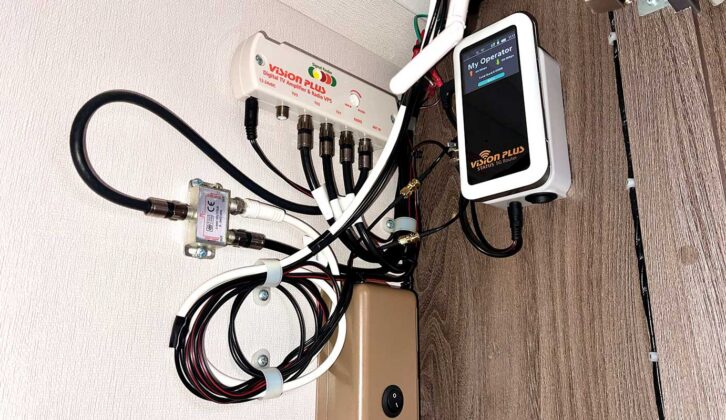

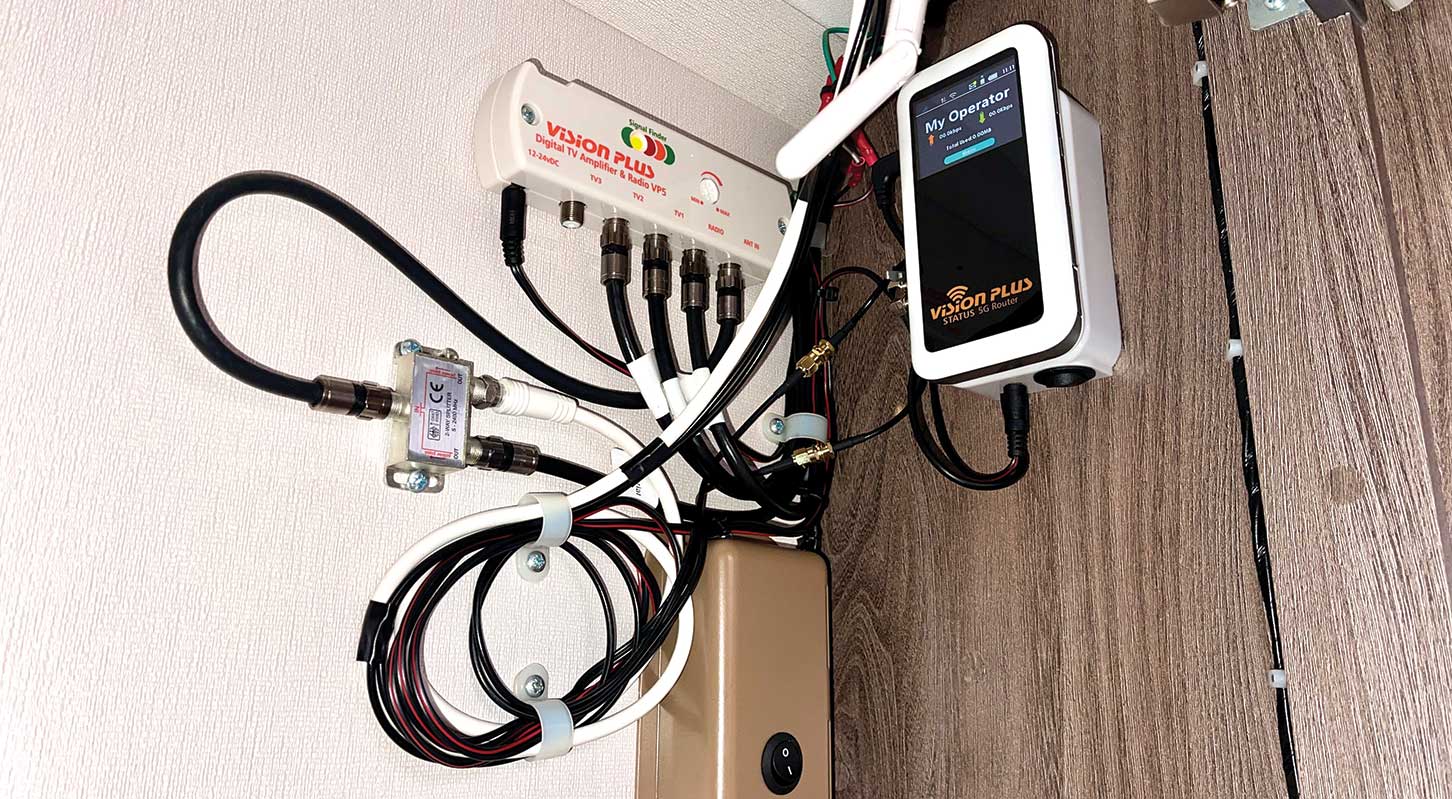

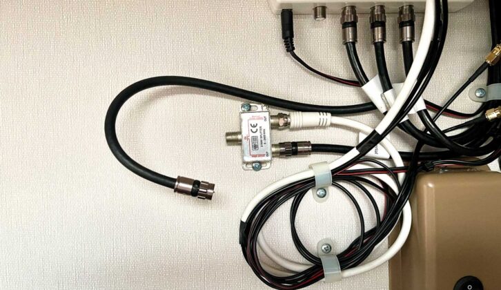

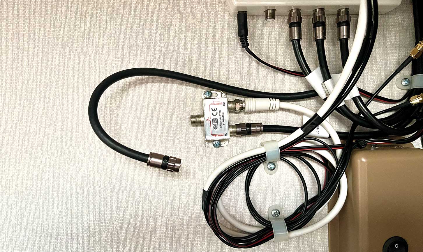

Start by disconnecting the lead from the antenna at the amplifier (if fitted). In our case, the caravan is fitted with a splitter, where there’s a lead from the antenna and another from a satellite dish connection that connect to one side with a single output on the other that goes to the amplifier – so it was the latter connection that was disconnected.
The TV antenna/amplifier/splitter and Wi-Fi set-up
The TV antenna/amplifier/splitter and Wi-Fi set-up in our caravan

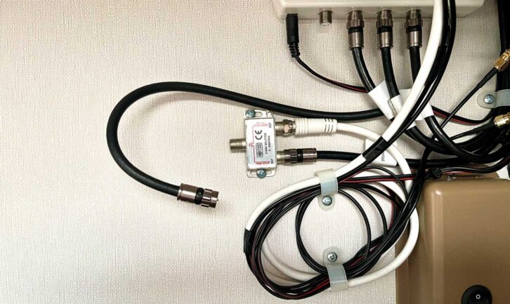

The splitter has F-type (screw-on) connections, as does the amplifier. With no splitter fitted, you’d only need to detach the cable from the amplifier.
The detached lead
Detach the lead from the antenna to the amplifier (or in our case, splitter to amplifier)

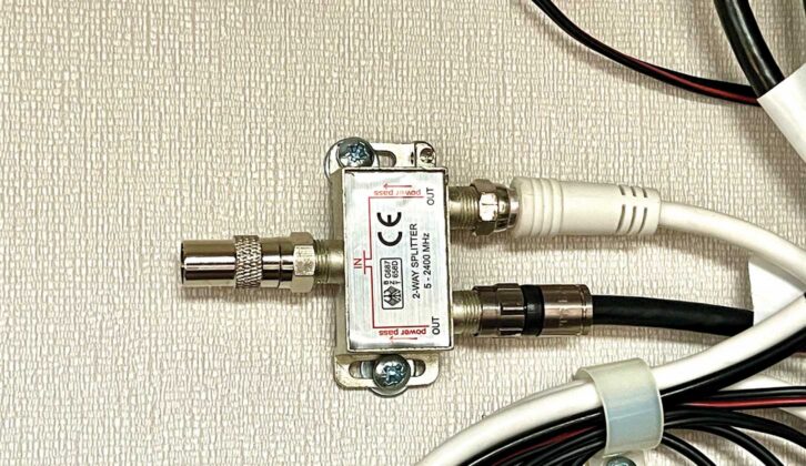

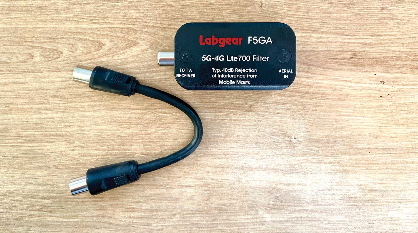

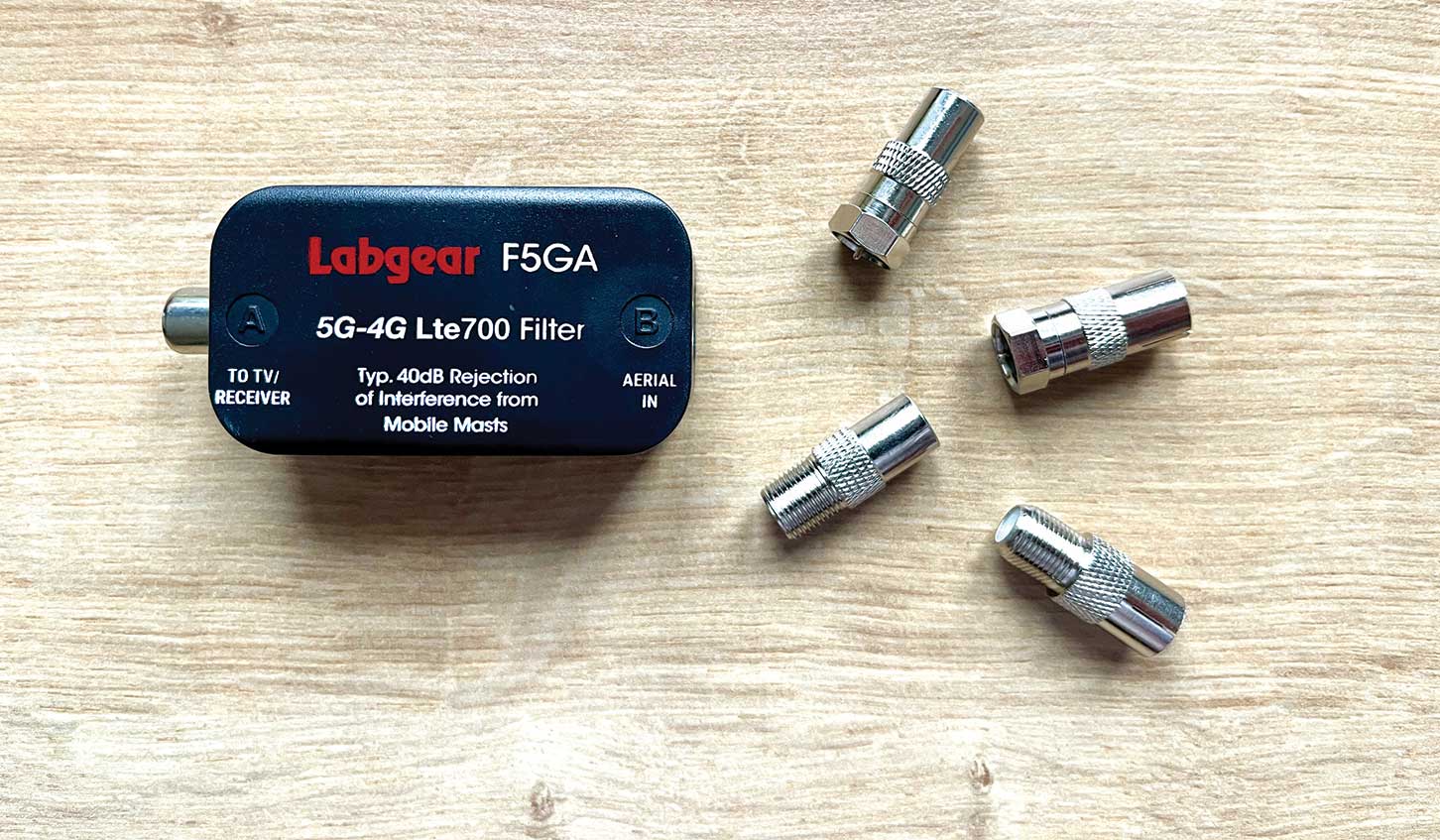

As the filter unit has the usual co-ax TV-type connections, you’ll need adaptors to connect these to the F-type connections on the lead, or will have to alter the connections appropriately.
The splitter fitted with the F-type
The splitter fitted in our caravan with the F-type to co-ax TV adaptor attached

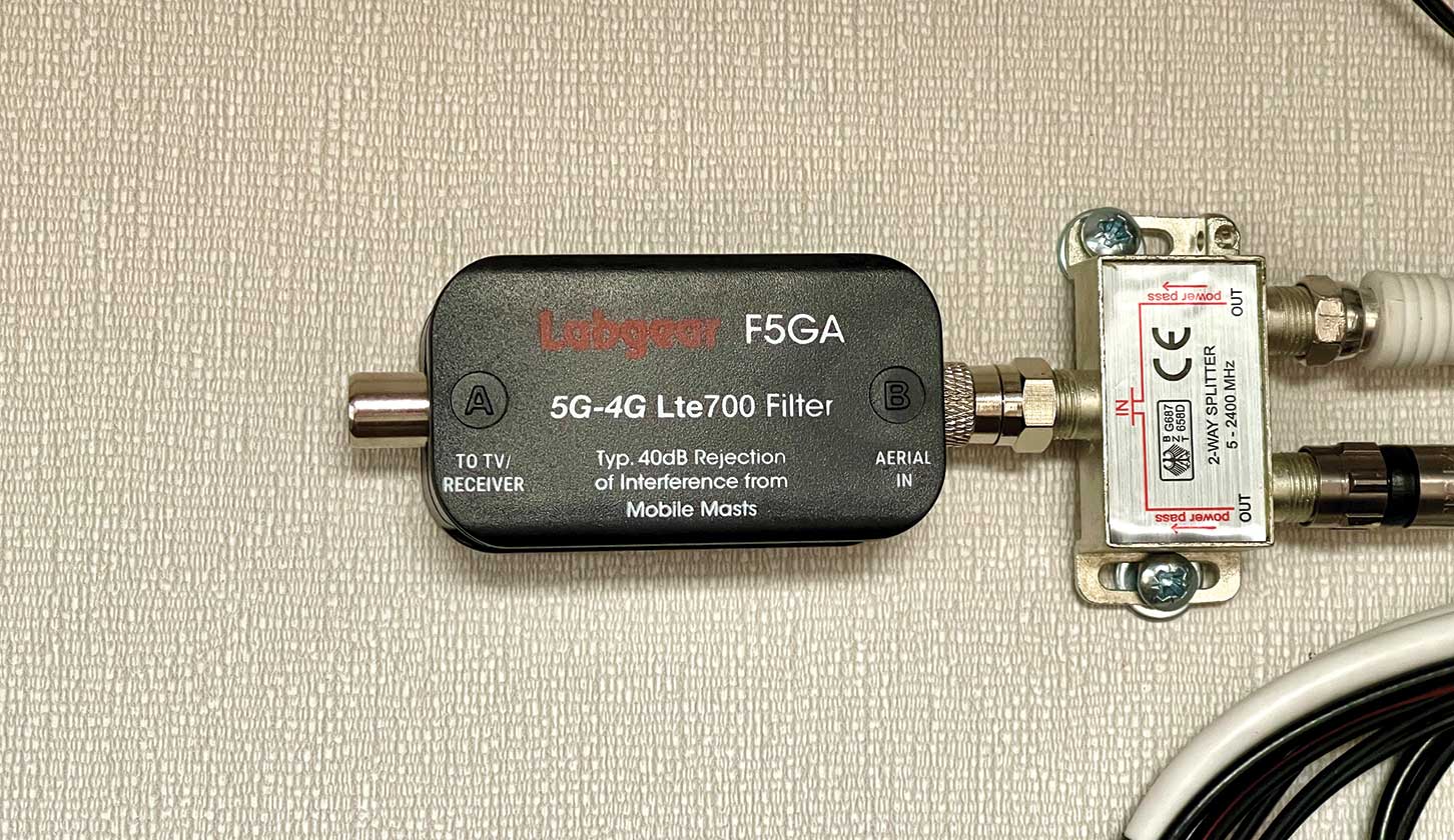

Attach the appropriate adaptor to the lead from the antenna (or in our case, to the splitter) and then plug that into the ‘Aerial In’ socket on the filter.

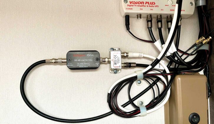

The filter unit attached to the co-ax adaptor
Attach the filter unit to the co-ax TV adaptor with option to secure it to the wall
You may choose to secure the filter to the caravan wall using double-sided tape, as I had done with the original lead from the splitter to the amplifier.

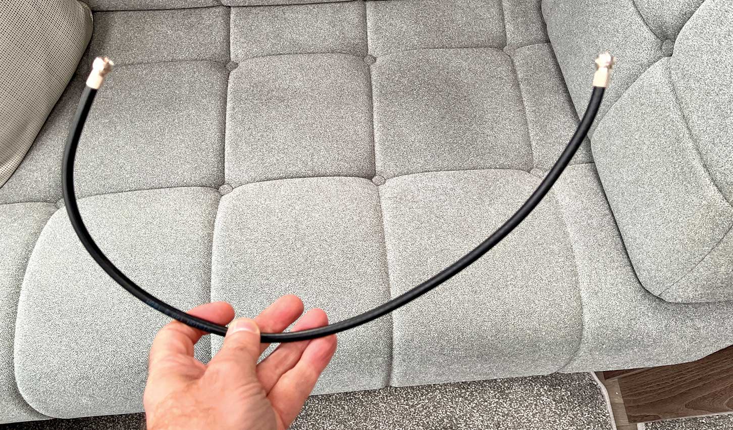

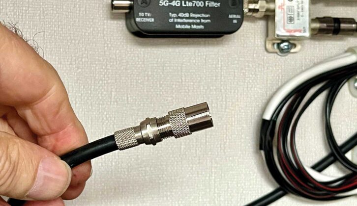

Make up the lead
Next, make up a lead to connect the filter to the amplifier/television
You might need to make up a second lead and, rather than using an adaptor on this side of the filter, fitting the appropriate co-ax TV connector to the lead.

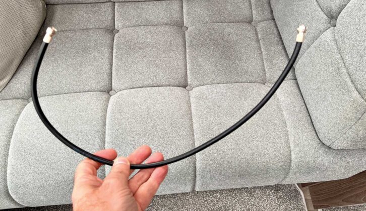

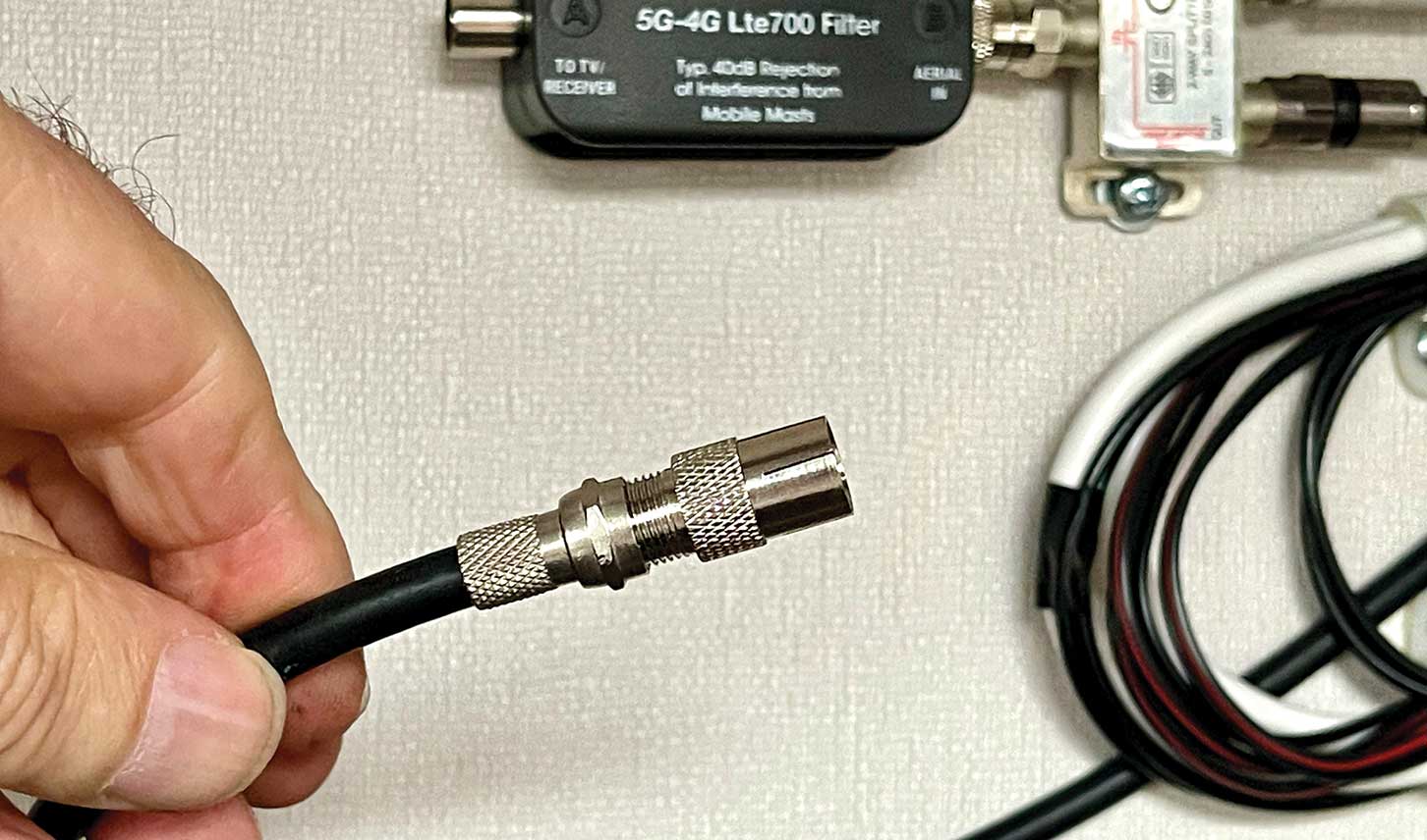

Connect the lead to the filter
Connect the lead to the filter using either a co-ax connector or suitable adaptor
I fitted another adaptor between the filter (to ‘TV Receiver’) and the original lead. And that’s pretty much it. I said it was simple! To keep things secure and tidy, I attached the lead from the filter to the amplifier to the caravan wall using P-clips and short screws – obviously you need to keep them short so that you don’t accidentally penetrate the outer skin of the caravan!

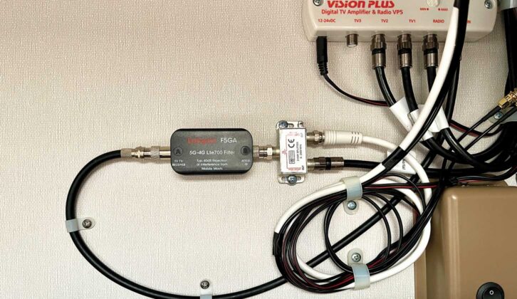

The connections finally made
All the connections made, with the cables coiled up neatly
