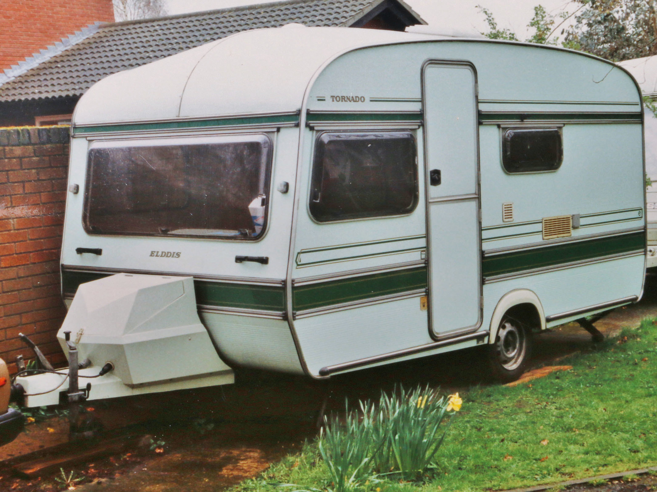

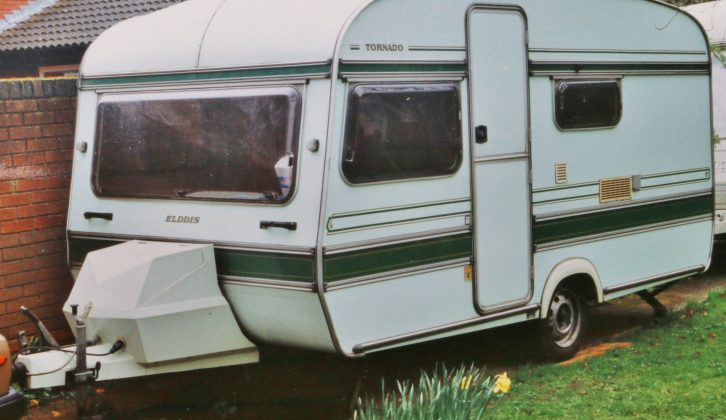

In this overview, the focus is primarily on caravans built over the past 40 years. The period embraces models that have an insulated sandwich floor panel, a lightweight chassis, and most caravans with ‘plastic’ windows. The Elddis Tornado adopted this style of construction, although its early Al-Ko chassis was painted rather than galvanised. Similarly, its frameless acrylic plastic windows had single panels: double-glazed units were only fitted in top-of-the-range caravan models in the early 1980s.

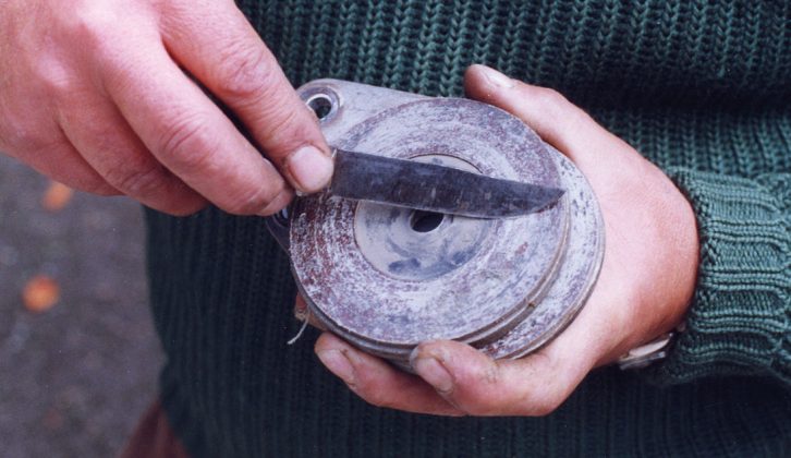

It’s important to realise that, while brake assemblies on 1980s caravans were fairly easy to dismantle and reassemble, things changed in the early 1990s. When sealed bearings and ‘one-shot nuts’ were introduced, gaining access to brake shoes required ownership of specialist tools such as a costly torque wrench. For that reason, I strongly recommend that anyone undertaking a major renovation project should have a mobile caravan service specialist get items such as brakes in safe running order from the outset.

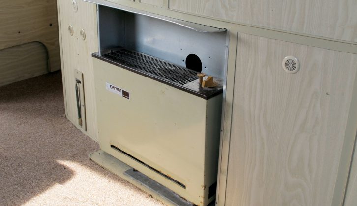

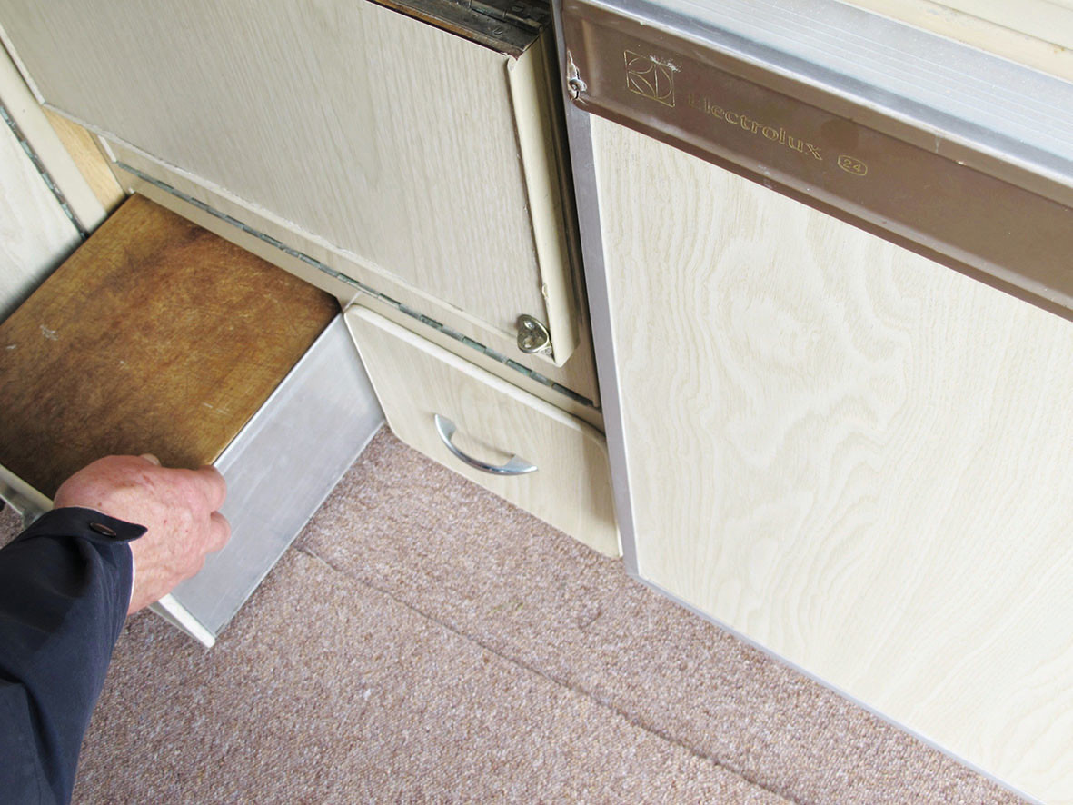

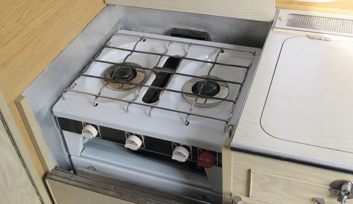

Without doubt, the kitchen unit in the older van and its appliances bear little resemblance to those in a modern caravan; but, as in our homes, kitchens are costly to replace. They also encompass the heaviest group of appliances in a caravan, and a kitchen’s location in the overall layout can be significant. For instance, when a chassis is designed and the position of a caravan axle is calculated (in order to achieve the appropriate noseweight), kitchen position is a key factor.
The old caravan kitchen pictured above would benefit hugely from some newer kitchen appliances, but I’d install them in the same location. Similarly, the space-heater recess could take a newer replacement; although minor changes to the furniture may be necessary to achieve that.
Altering furniture and mounting a gas appliance in accordance with its manufacturer’s instructions is something a skilled joiner can usually manage, but that’s as far as it should go: installing a new gas-supply pipe and coupling it up to an appliance must only be carried out by a competent and experienced gas installer.

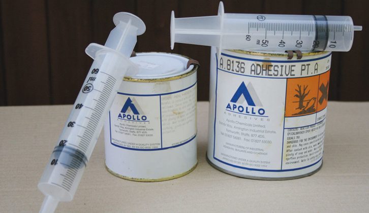

However, some floor panels fail when the bonding agent shears in high-use zones (typically just inside the door, and also around the kitchen). Once this delamination spreads, the floor loses its strength dramatically. Incidentally, you should suspect problems if part of the floor starts creaking badly and feels ‘springy’ in places. In a severe case, the top layer of ply rises up like a shallow blister.
Fortunately, delamination can usually be cured and kits are available with detailed instructions. Since an error can have disastrous effects, some kit manufacturers only sell their product to dealer workshops. As an example, if you forget to mix the hardener chemical into the two-part bonding agent, the repair will fail. See the photographs and captions above for a quick overview of the process.

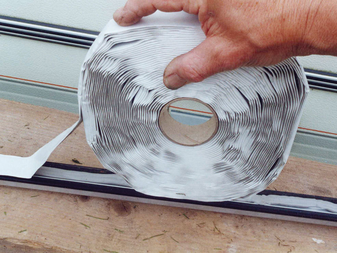

Countless caravans have been affected by leaks in the past. Although ill-fitting items such as windows can sometimes cause weak spots, most problems occur where the screws that hold trim strips deteriorate. That’s especially common when ordinary steel screws have been used (instead of stainless-steel fixings). Every screw hole represents a potential leak point, so a flexible mastic is used, too.
Unfortunately, the heat of summer eventually dries the mastic, whereupon it loses its flexibility, cracks and falls away. That’s when the mastic must be replaced, new holes drilled and stainless-steel screws used throughout. If this job is delayed, the core of the wall becomes damp, and timber struts start rotting. Then, the decorative ply on interior walls develops damp patches and goes mouldy.

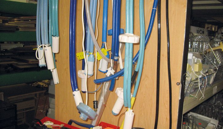

Waste- and fresh-water supplies are considerably easier to understand, and the low-pressure plumbing in caravans is less tricky to deal with than the domestic version. I’m often disappointed by the plumbing provision in caravans, but there are numerous ways to improve standard systems. For instance, far too many waste-pipe runs have downturns – and some include uphill slopes!

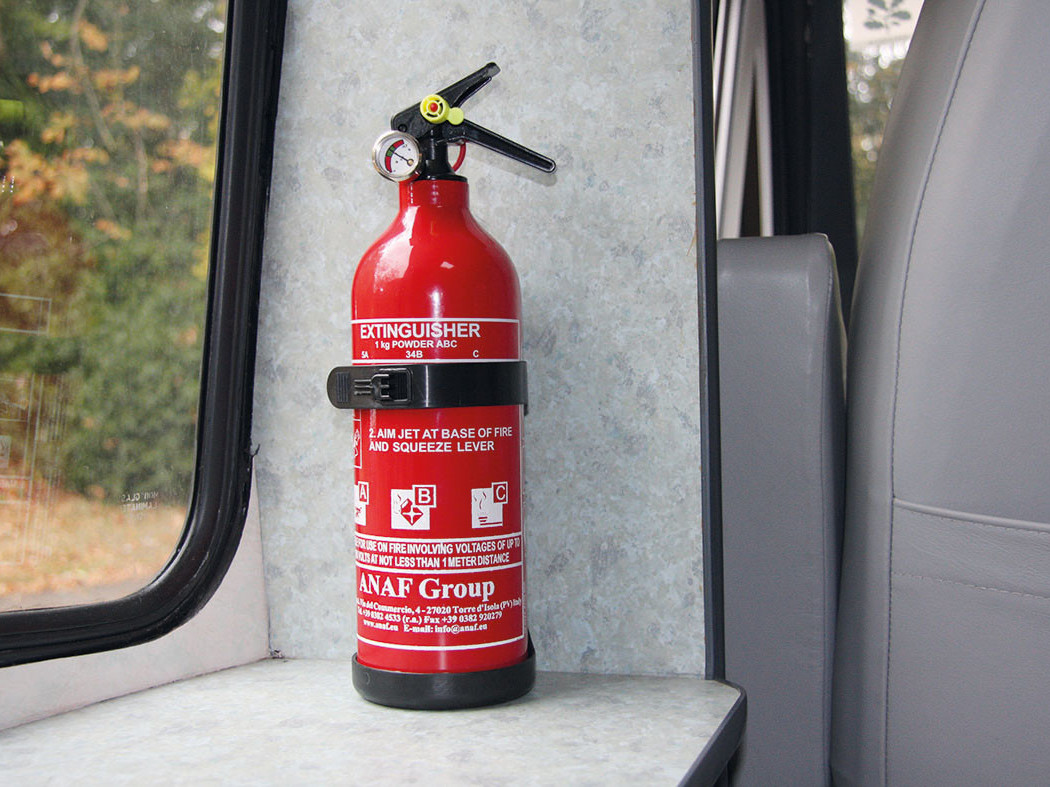

Finally, fit these detectors
The provision of safety equipment is far more regulated than it was in the past. While DIY owners don’t always have to fit the warning devices now obligatory in modern vans, it’s silly not to adopt the latest practices. So when your upgrading work is reaching a conclusion, consider purchasing (and mounting in the appropriate place) items such as a smoke alarm, gas leak detector, carbon monoxide alarm, fire extinguisher and fire blanket. These items are readily available in caravan accessory stores, car accessory stores and even some large supermarkets. They may never be needed, but why take any risks?
