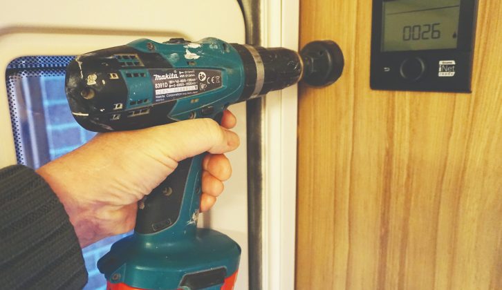

After checking behind the panel, I used a 50mm hole saw to cut a hole in a wooden partition to hide the tube inside a cupboard with just the end exposed, next to the kitchen. The off-cut of black Perspex labelled ‘Fire Blanket’ was the final touch.
