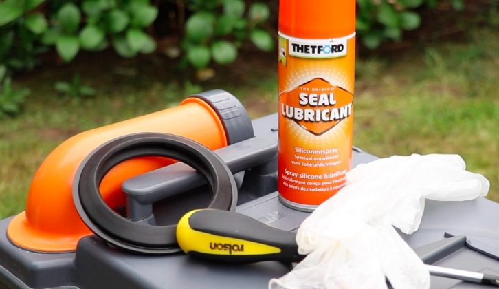

What you will need
- The replacement seal – Thetford part number 23721
- A Philips screwdriver
- Thetford Seal Lubricant (or olive oil)
- Rubber gloves
- Thetford Tank Cleaner (this is optional, but means that you’ll have a fresh tank afterwards)

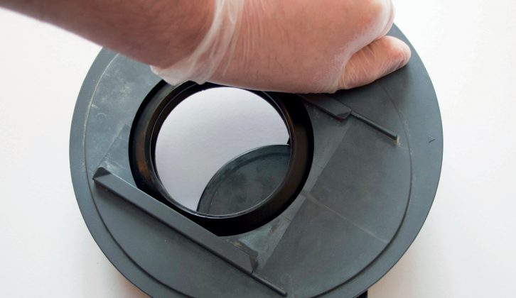

Remove the plastic cover plate and replace it halfway into the other side. This will provide a lever to help you twist off the top.
Gently apply pressure from the right-hand side, and push in an anti-clockwise direction, so the lid slowly unlocks. Keep twisting until the lid arrow points to the unlocked symbol.
Now gently lift the hatch assembly out of the cassette and place it face down. We won’t need the tank until later on, so at this point you can give it a clean, if it needs one.

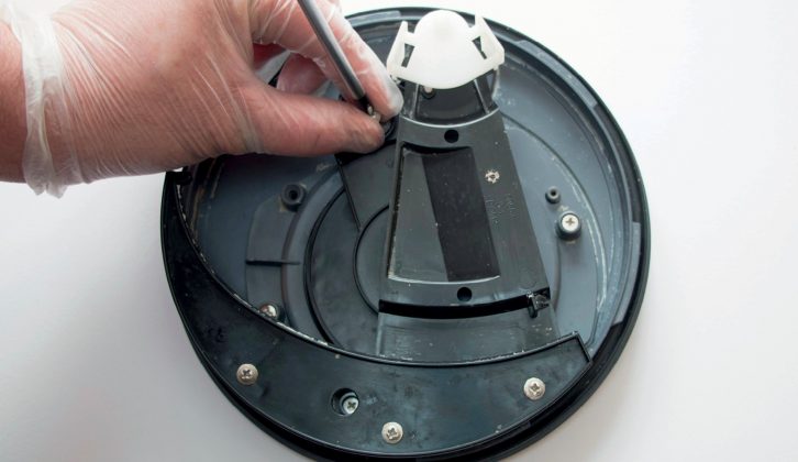

We need to remove two parts from the lid. First, the blade (the circular cover) and the swing arm (the triangular section) must come out in order for us to gain access to the six screws and the seal itself.
To remove the blade, we need to undo the single screw that holds this part in place.
Once that is done, we can simply move the swing assembly out the way and pop off the blade.
Move the swing arm towards the right and gently manoeuvre the swing assembly out the way, and this will give us access to the six retaining screws that hold the rubber seal in place.

Now, simply unscrew all of the retaining screws and lift the cover out of the way, then remove the rubber seal beneath.
This is a great time to clean the edges of the cover and the retaining clamp where the seal will fit.
Cleaning these surfaces ensures that the seal will fit flush and not allow any fluid to leak beyond the seal.
