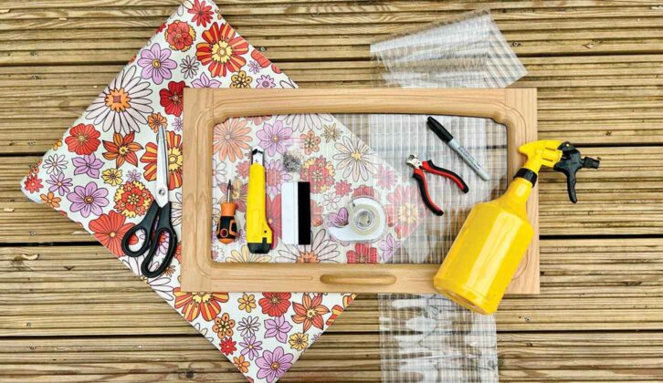

The tools used for the upgrade

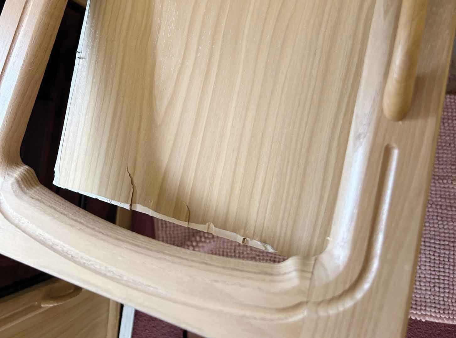

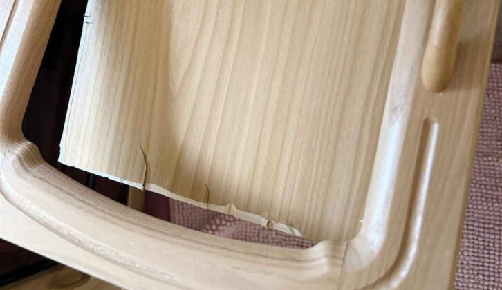

Penny’s doors were built in a pretty traditional way, with softwood frames and an inset panel stapled into the middle. The panels are thin plywood coated in a wood-effect vinyl, which provides the effect of wooden cabinets but without the weight of heavy timber.
It worked well enough, but after 25 years of being bounced around in a caravan, a few of the centre panels were making a bid for freedom. We decided to grant their wish – it was time to reach for the caravan tool kit.

Removing the infill panels was simply a matter of holding the wooden frame and pushing on the panel with firm thumb pressure. This eased the panels out and left the staples in place.
An infill panel
Infill panels were pushed out without much effort

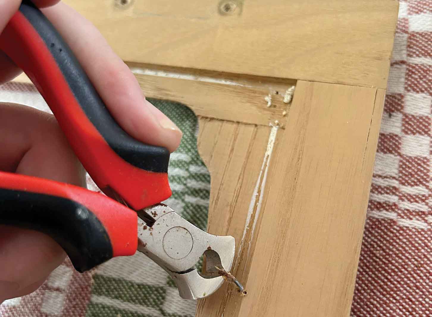

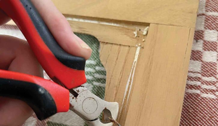

We used pliers to whip out the staples and this gave us a flat lip to fit a new infill.
Removing a staple with pliers
Old staples were removed with pliers

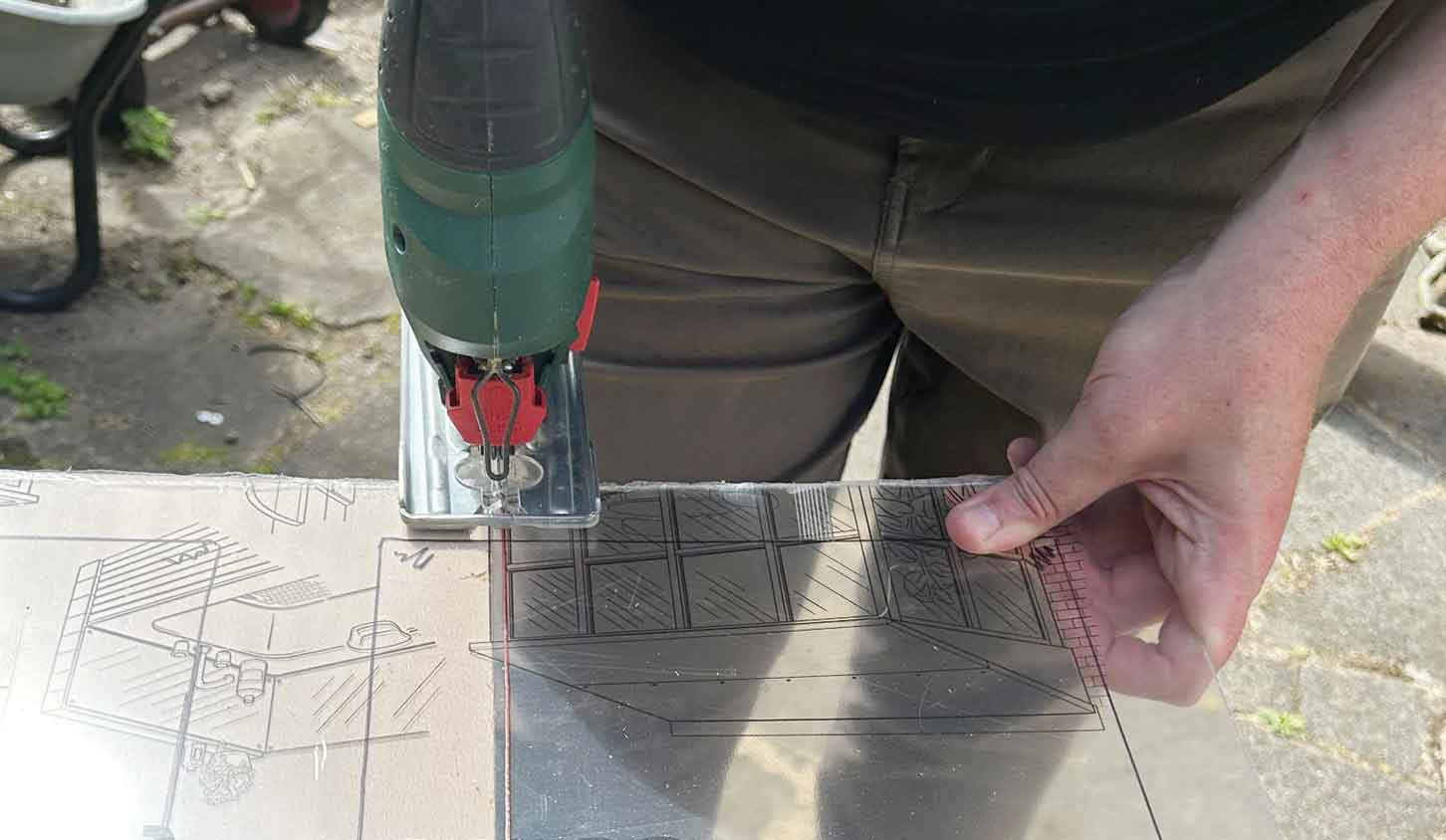

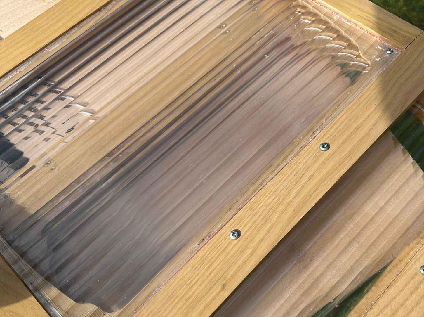

We bought a sheet of 2mm Perspex from Wickes, measured the recesses on the back of the doors and cut the pieces to size.
Cutting the Perspex
The old panels were used as templates for cutting the Perspex
A sharp knife is what Wickes recommends for cutting the plastic, but we found a circular saw gave a good straight edge without the risk of wrist injury. The cut pieces were laid on the back of the doors to ensure a neat fit.

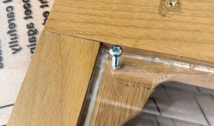

There was quite a sizeable recess to inlay the Perspex into, so being millimetre-perfect was not a requirement. The final task was to drill 2mm holes in the corners of the plastic, inside the recess, to allow for some panhead fixing screws to hold things in place. We did consider gluing them into position, but using the screws meant that if we ever want to take things apart in future, it would be easy.
Panhead screws secured the Perspex

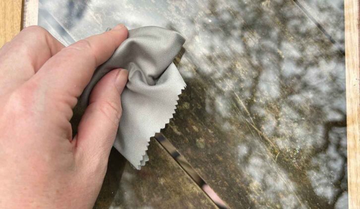

With that all ready, the final task was cleaning the Perspex, before applying the film.
Cleaning the panels
The panels were cleaned with a microfibre cloth to remove any dust

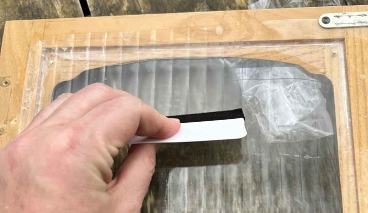

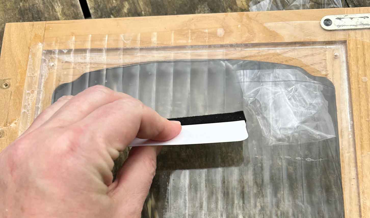

The instructions for the film are to get the surface damp and use the supplied mini-squeegee to push out the bubbles for a clean look. We had a couple of small issues, mainly caused by bad alignment and dust getting between the film and the plastic, which necessitated reapplication, but it is a simple enough task and it looks great once it is done. When the film had dried, we were ready for reassembly.
Pushing out bubbles with squeegee

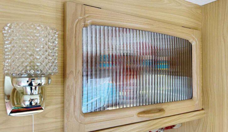

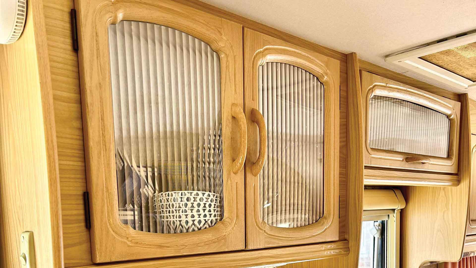

Reattaching the doors to the hinges was fiddly. Leaving the hinges on the doors, not the cabinet body, might have been easier. We’re pleased with the result, though, which looks sharp enough to have come from the factory.
Interior view of smart new doors
Now we can spend time living with the updates, then decide if we want to add new handles or in-cabinet lighting – or just quit while we are still ahead.

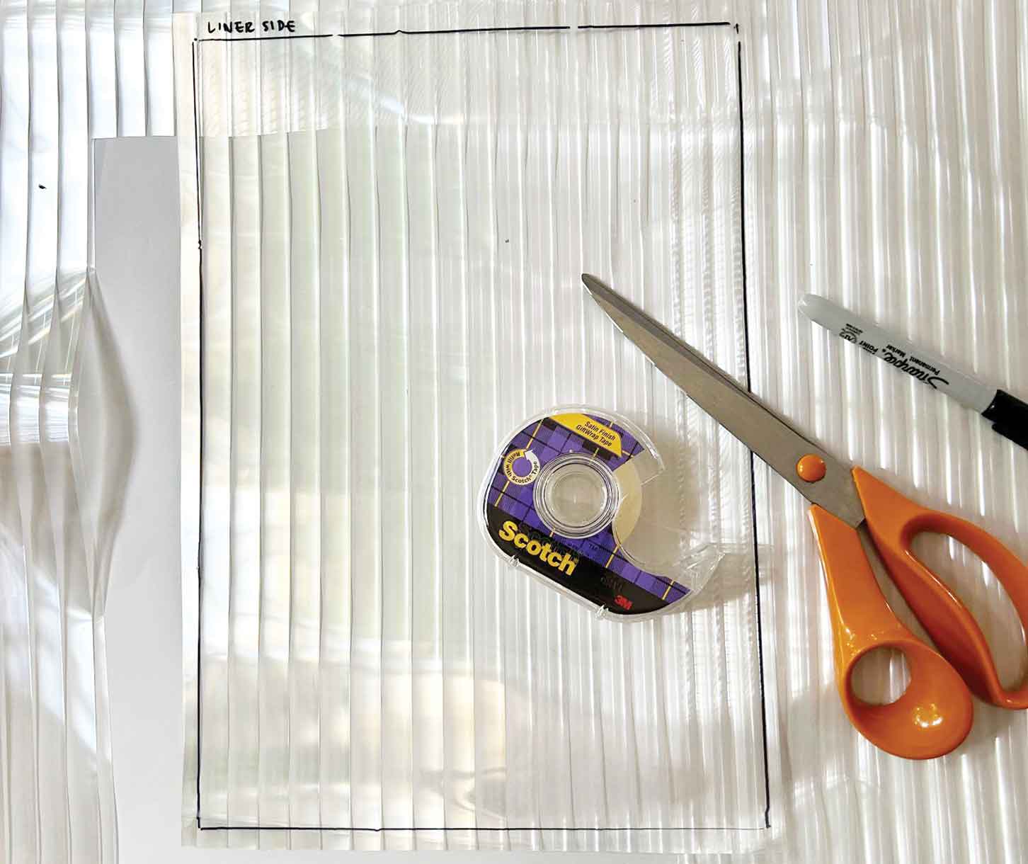

4. Fluted glass-effect film was trimmed to match the Perspex.
Fluted glass-effect film with scissors and tape

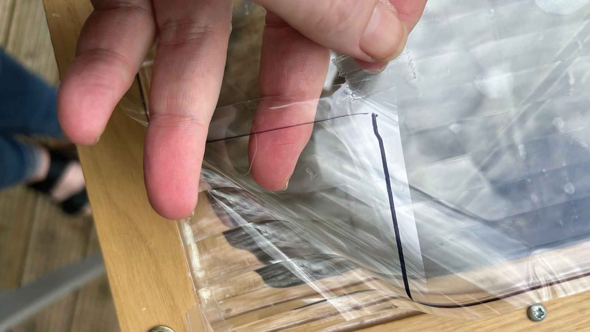

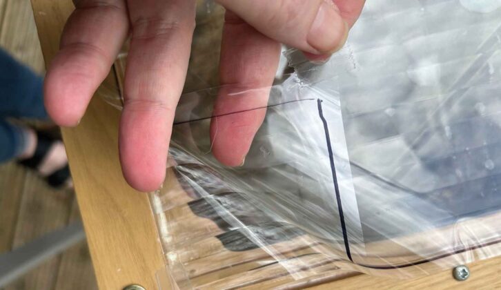

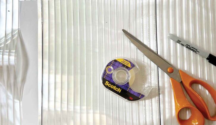

6. The film was held roughly in place on the Perspex.
The films held in place

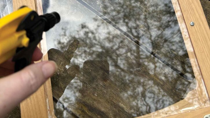

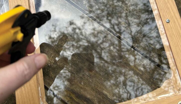

7. A mix of water and washing-up liquid in a spray bottle helped position the film. Once we were happy with the fit, the backing film was removed. Water was applied to the adhesive side before sticking it on the Perspex.
Removing the backing film
8. Pushing out bubbles with squeegee.

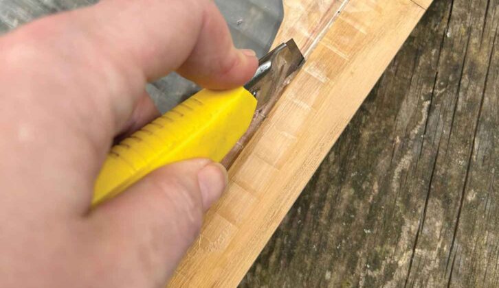

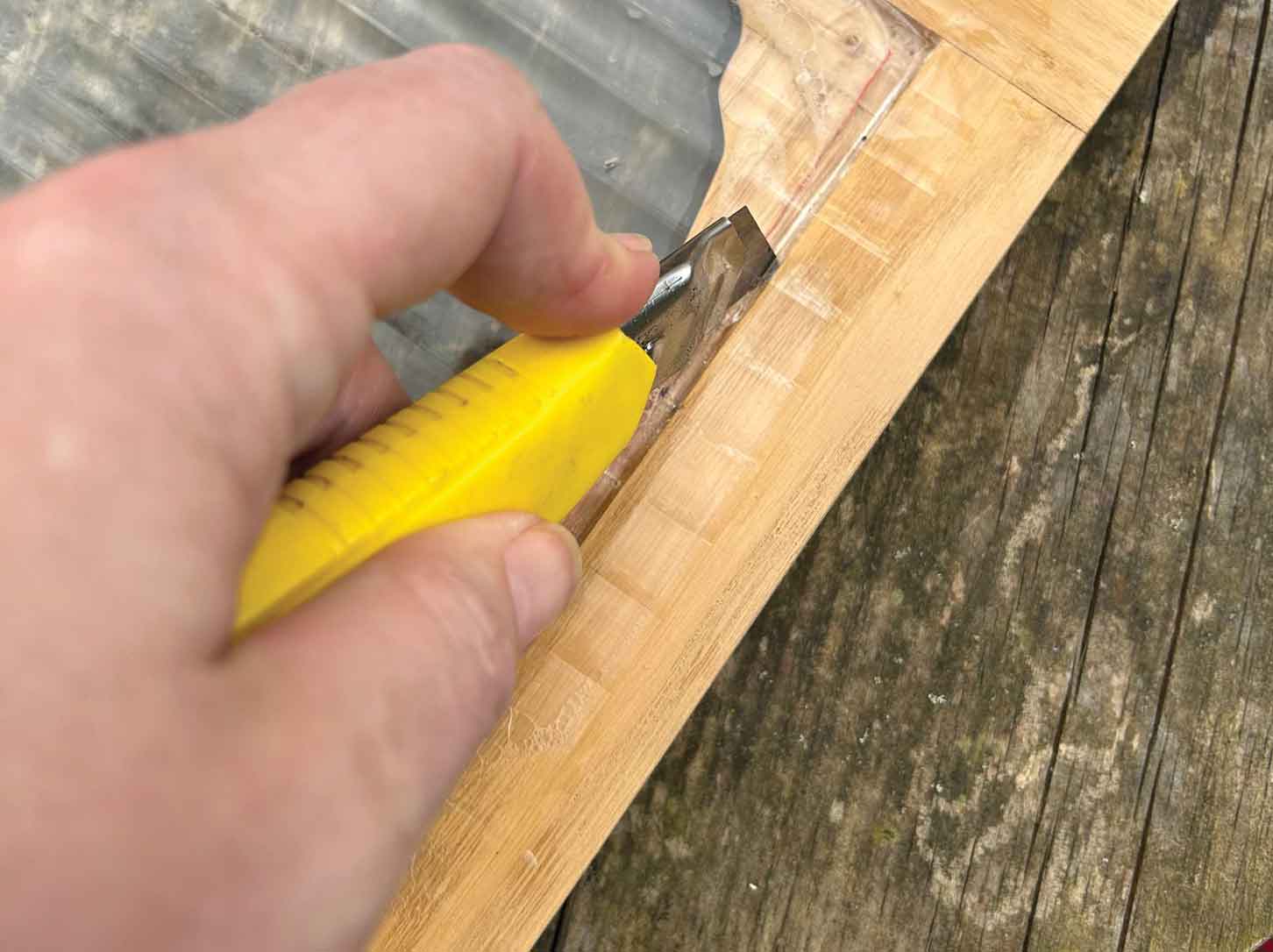

9. Trimming excess with a sharp knife.
10. Panhead screws secured the Perspex.
