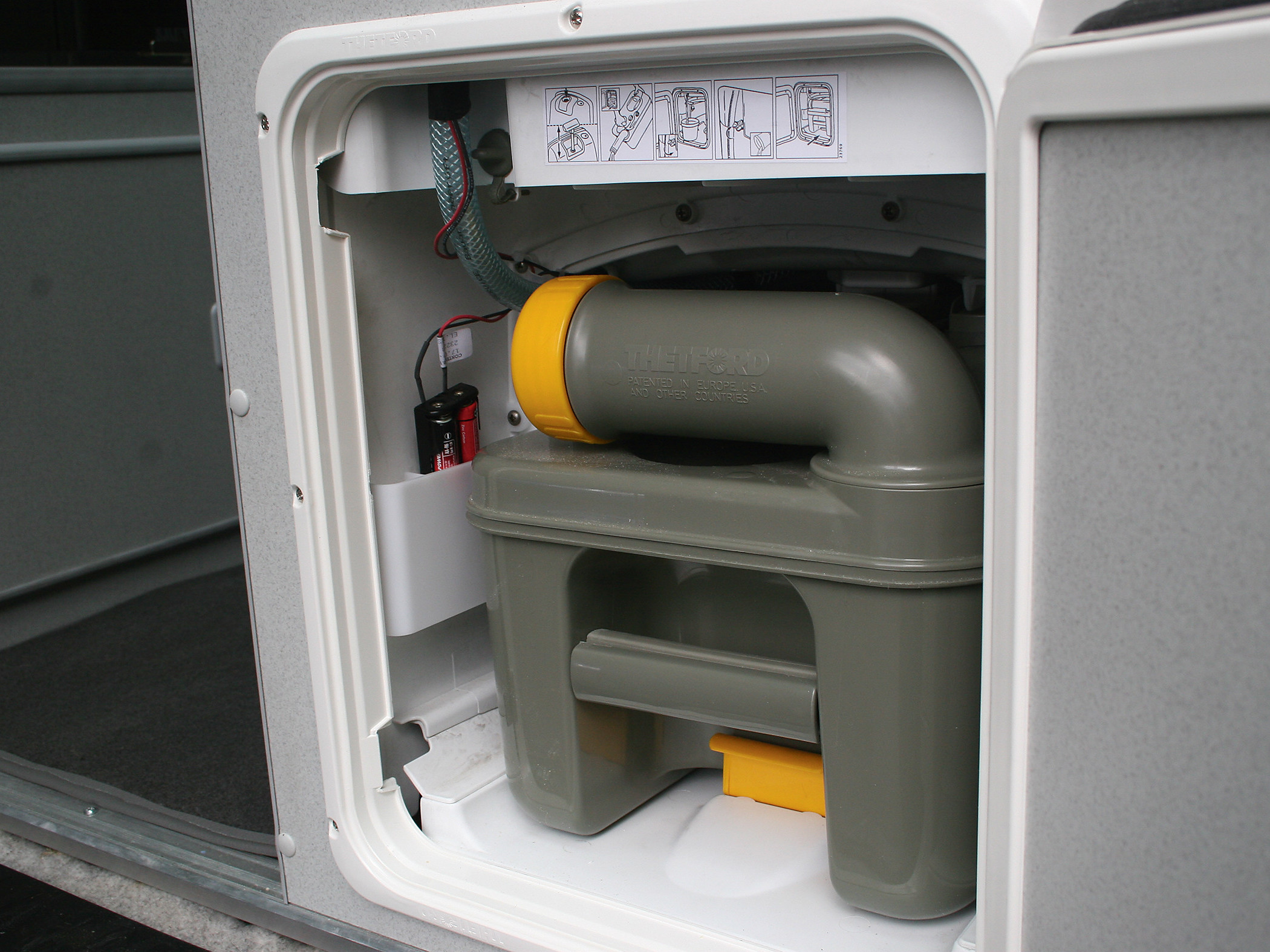

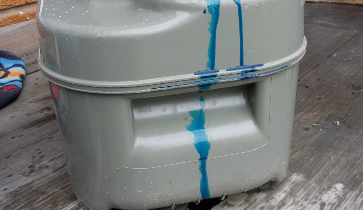

Evolution also improved cassettes, and from an early stage they were equipped with a float mechanism and an indicator to warns users of a full tank. There are several moving parts in a cassette, plus ‘O’ rings to prevent leakage, so repairs can be tricky.

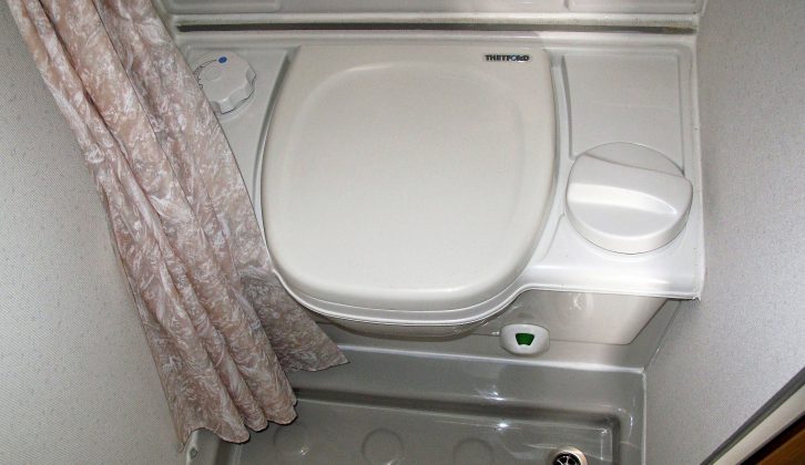

For modern portable products the cassette, seat and bowl are one unit, with a removable lower half. In fixed versions, a special bay houses the cassette, with external access for emptying.

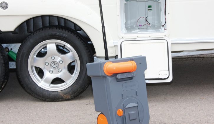

One common error is to remove the cap on an emptying spout and place it near the waste point. It only takes a knock for it to disappear along with the waste, block the drain and infuriate the warden.

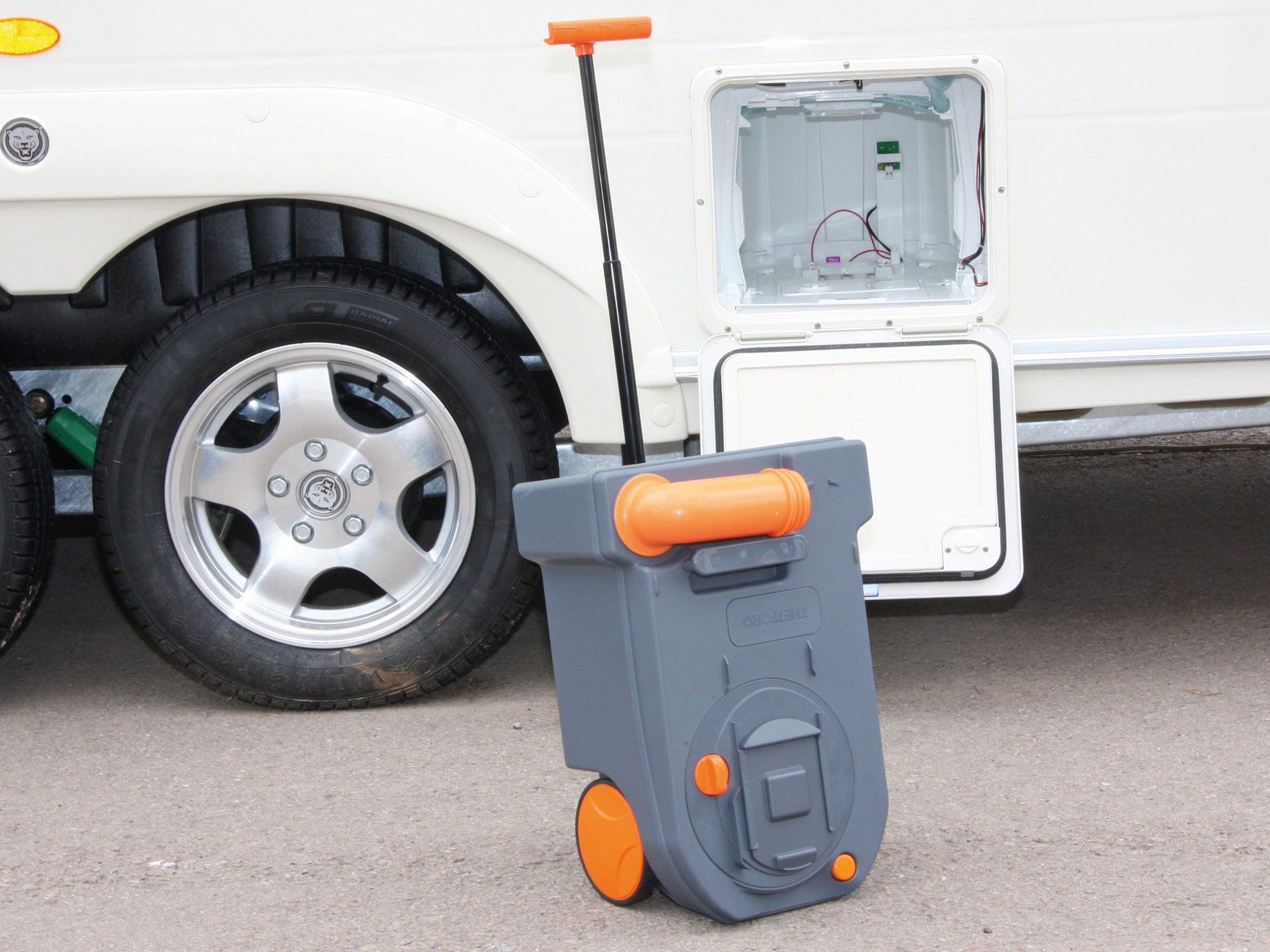

Most chemical toilet emptying points are equipped with a water hose, which is useful for dislodging trapped toilet paper from inside a cassette. Never take a cassette to normal waste-water drains with a similar fixed hose.

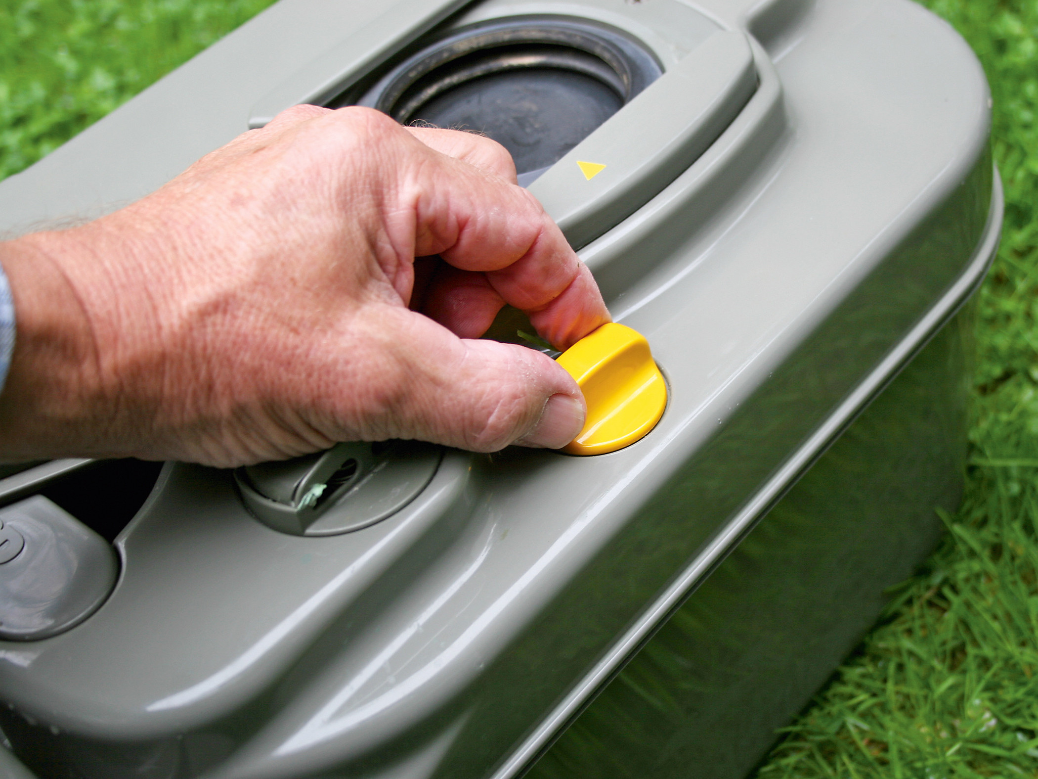

Many make the mistake of adding water to a cassette then shaking vigorously before emptying it. This seemingly sensible act often damages the float mechanism that operates the tank level gauge. Add water, but remember to swirl it around gently.
If you’ve opened the slider flap to hose the interior and check that it is free from caught paper, you must close the flap before returning the cassette to its housing. If it’s left open, the operating knob won’t align when entering the housing.

Several cassette components have ‘O’ rings to prevent seepage. Replacements are available, but can be hard to fit. The emptying spout is easier because it detaches from the casing.

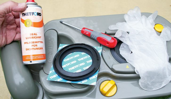

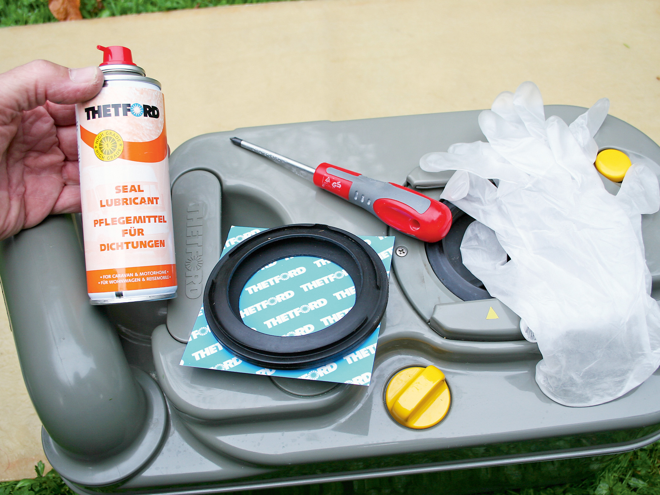

The rubberised ring by the opening blade is the ‘lip seal’ and is easy for DIY owners to replace on all types of cassette toilets, although you need to buy the right one for your product.
When fitting a new lip seal, make sure it is fitted the correct way up and get hold of a tin of Thetford ‘Seal Lubricant’.

The latest Dometic product, shown in our penultimate photo, has similar innovations to the modern Thetford cassette, and this alternative model has been fitted in some recent Lunar caravans.
