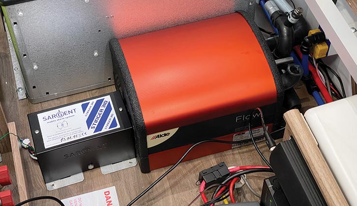

Put simply, the Alde Flow is a pre-heater that is plumbed into the heating system and runs in tandem with the boiler. When empty, it weighs in at just over a couple of kilos.
Cold water from the Aquaroll (or other water supply) passes through the Flow, which heats it to 20°C. This heated water goes directly into the hot water boiler, which in turn heats it to at least 40°C, which is plenty warm enough for anyone to take a continuously hot shower.
I say ‘at least 40’ because if the water in the boiler is warm to start with, the temperature at the tap will be higher than 40°, as the temperature of the glycol used to do the heating will be in the region of 70°C.

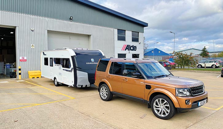

So what’s involved in fitting a Flow unit? Phil Broadbent, the Service Manager at Alde, carried out the work on our caravan. First, the system is fully drained of fluid, because various connections into the boiler will be disturbed. It’s bad enough having a clean water leak, but glycol is horrible.
With the system drained down, a suitable location for the Flow is sought – and the nearer the boiler, the better.
In our case, that was going to be next to the boiler, under the front offside bunk.
With the Flow in position, Phil went about constructing the bespoke plumbing. He took care in making the plumbing look as aesthetically pleasing as possible and, of course, in ensuring that it would work as efficiently as possible, too.
With the plumbing sorted out, the Flow unit was secured to the caravan floor and its electrical connections to the boiler were attached.
