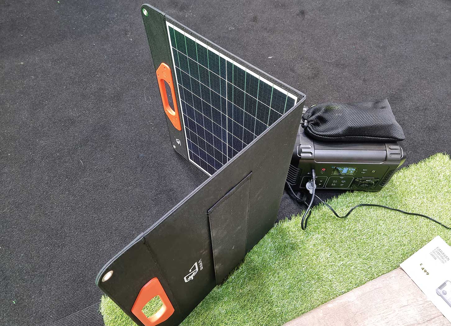

A few power banks link to folding solar panels, such as the Jackery Solar Generator 1000, while others are modular, allowing you to easily add more battery power to the power station should you need it.

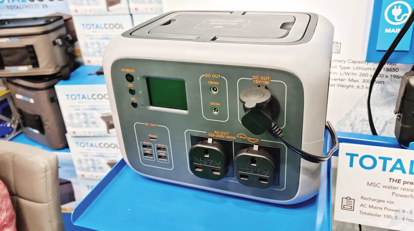

Almost all power banks include a built-in inverter that is linked to at least one 240V socket, and various USB and USB-C sockets, together with 12V sockets. Many now provide a variety of 12V outputs, for powering a wide range of electrical equipment remotely.
Some also have a wireless charging panel for mobile devices and built-in lighting, which makes them ideal for use in caravan awnings or tents.

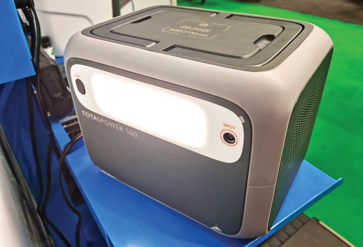

To give you a rough idea of the times involved, the Totalcool Totalpower 500 (which has a 40Ah battery) takes about seven hours to charge on a 90W mains charger and around 11 hours to do so on a vehicle charge.

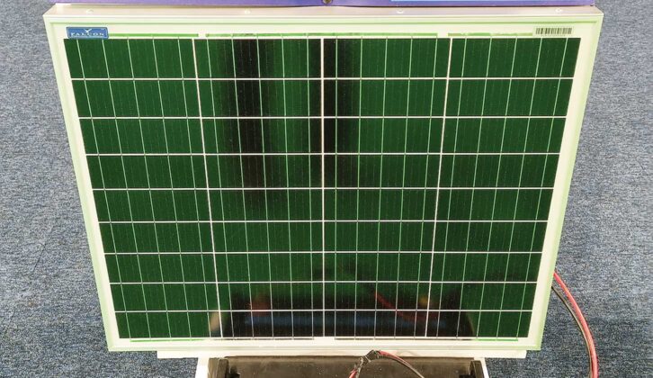

Solar takes around eight hours when using the optional £300 100W solar panel, but this assumes eight hours of full sun, and in the UK – classed as a cold climate – this isn’t always assured.
On cloudy summer days, this might double – so two days to charge up via solar is possible. However, the unit can be used while it’s charging, so this could still extend your usable power.
During the winter months, all power stations will take considerably longer to recharge in the UK, so you would definitely be better off charging them up from the mains supply.
Some of the larger units – those with 60Ah batteries and above – would need several hundred watts of solar power to recharge, even at the peak of summer. These would take days to charge up with just a 100W solar panel, so it’s really most practical to charge them via the mains.
