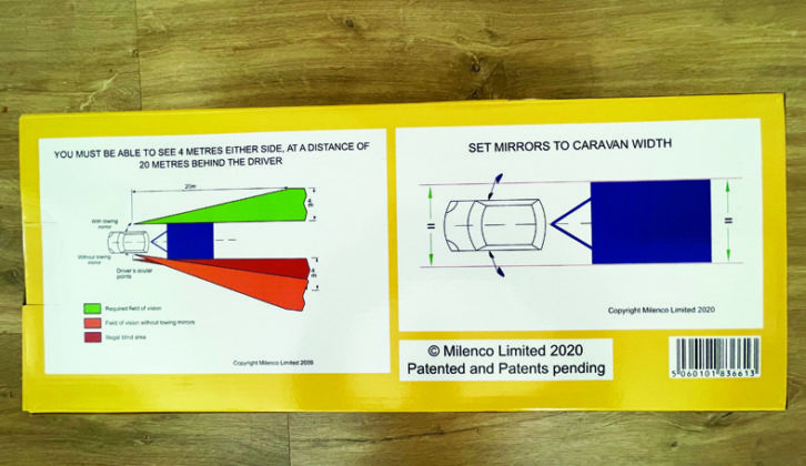

The law states that you must be able to see along the sides of the caravan and 4 metres either side, at a distance of 20m behind the driver.
In simple terms, from the driving seat, you must be able to see both rear corners of the caravan. In even more simple terms, if your caravan is wider than your tow car, you must use towing mirrors.

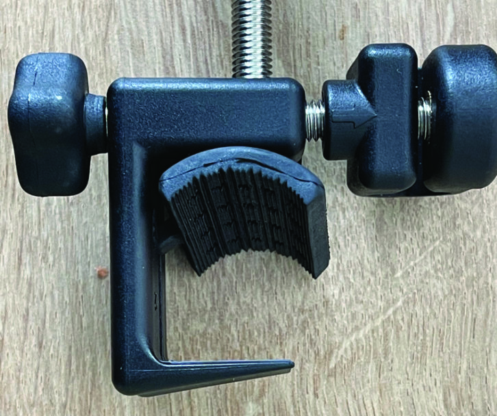

The biggest development, though is in the clamps. They now have a flexible rubber grip around a stainless-steel spring pad, with a larger footprint than previous incarnations, to fit just about any vehicle.

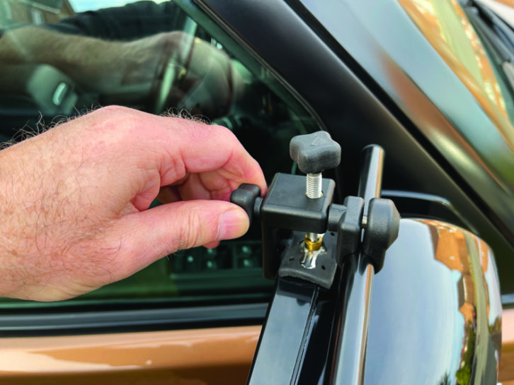

  • Loosen both thumb wheels on each clamp.

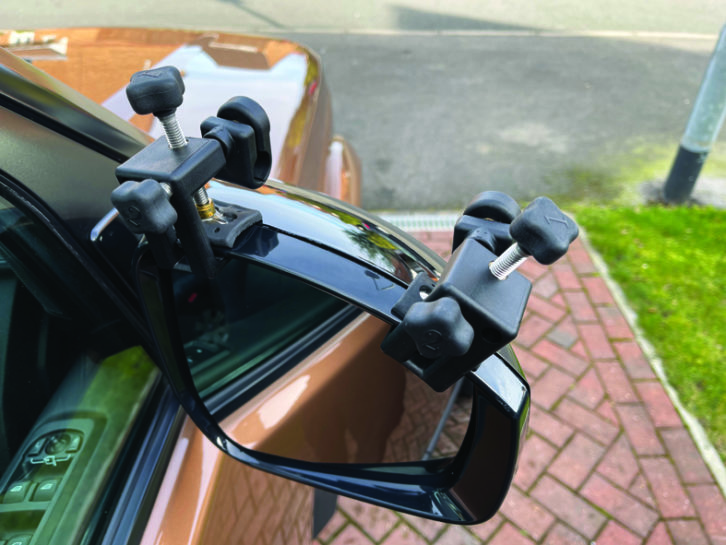

  • Slide the thin wedge of the clamp under the top of the car mirror’s housing as far as it will go and as near to the vehicle as possible. Tighten the thumb wheel to secure the clamp.
  • Put the second clamp as near to the edge of the car’s mirror housing as possible, and secure.

Legal requirements clearly displayed on the packaging
2. Legal requirements clearly displayed on the packaging

Clamps: Grand Aero (left); Grand Aero Platinum (right)
5. Clamps: Grand Aero (left); Grand Aero Platinum (right)
Flexible rubber grip on Grand Aero Platinum
6. Flexible rubber grip on Grand Aero Platinum

First, attach the clamp nearest to the vehicle
8. First, attach the clamp nearest to the vehicle
Both clamps attached to the mirror housing
9. Both clamps attached to the mirror housing
