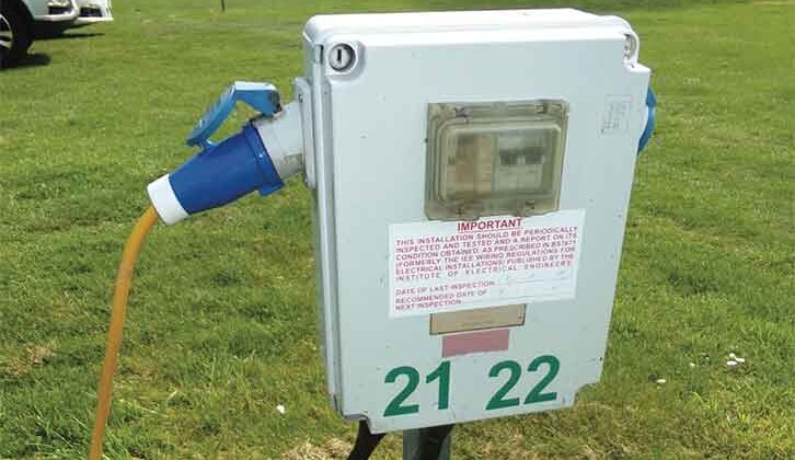

What is electric hook-up?
First things first – what exactly is electric hook-up? Put simply, EHU points are outdoor power sockets, which will typically be rated to supply 16A electricity in the UK (this is around 3.5kW), although certain sites will offer 10A. In some cases, you could find it’s even as low as 6A, particularly if you’re caravanning in Europe.
EHU is relatively simple, providing 230V AC electricity to every pitch by using underground cables that run throughout the site to the supply post. It lets you operate the essentials, as well as the luxury caravan accessories that can make a real difference to a tour.
The posts themselves are waterproof and may have two or more outlets for neighbouring pitches; they can also be lockable. They are designed to provide power to the pitch, allowing the caravanner to connect their tourer to the site’s distribution board. The EHU posts are protected by circuit breakers and earth-leakage devices too.

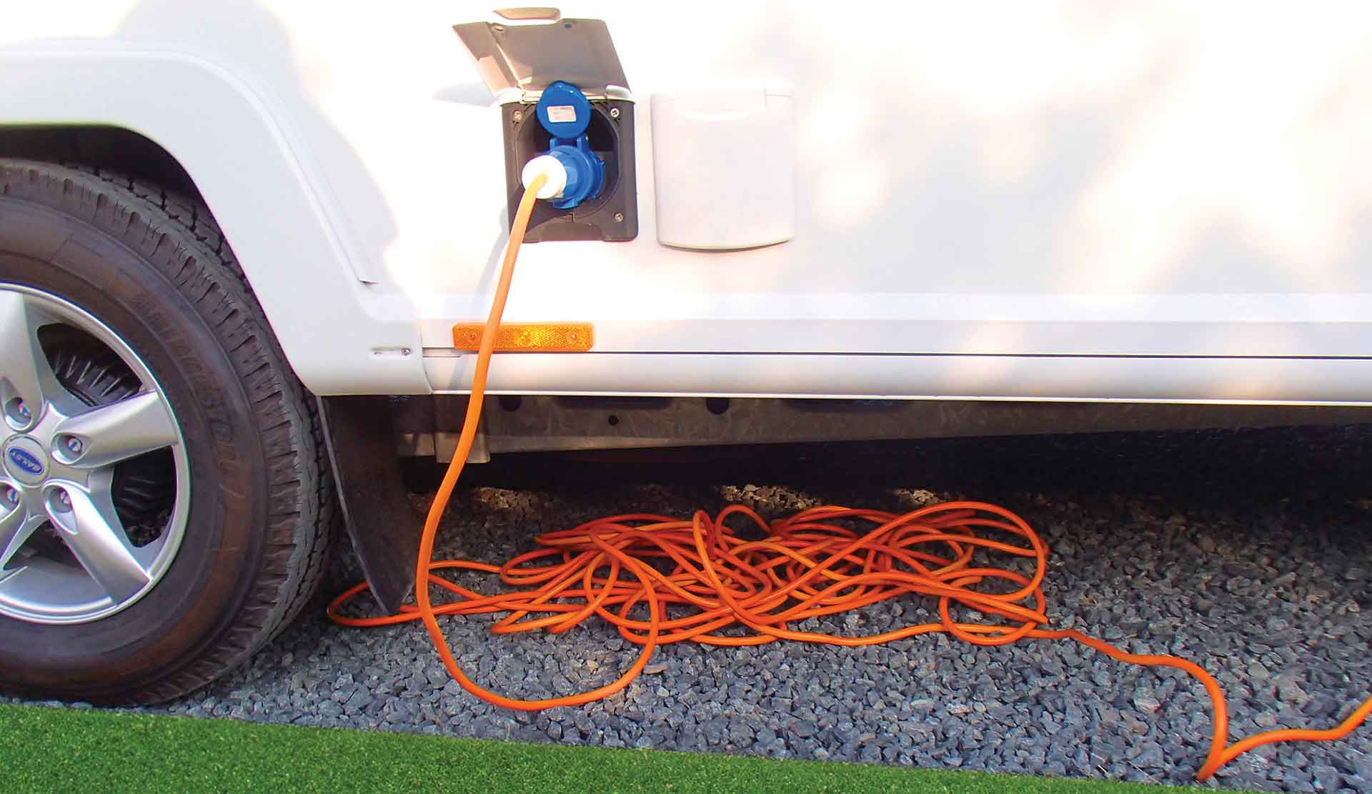

To get your caravan connected to electric hook-up, you will need a mains hook-up lead, which allows you to connect your caravan to the EHU post. These cables are generally orange to increase their visibility and come with three-round-pin connectors on each end, one male and one female.
The male connector will go into the campsite’s socket, while the female goes into the van’s socket, which can be found on the side of your tourer.
As standard, these leads are 25m long, while the wires inside are 2.5mm² in cross-section.
Thinner or longer cables are to be avoided – they can either cause a voltage drop or heat build-up. Instead, make sure your lead is CE-marked and complies with BS EN 60309.
So, now you know about the power lead, it’s time to find out how to connect your caravan:
1. Ensure your caravan’s isolating switch is turned to OFF.
2. Make sure the hook-up lead is uncoiled – if it is coiled and has current flowing through, it could lead to it overheating, particularly if you are using high-current appliances.
3. Plug the female connector end into the socket on the side of your tourer.
4. Lift the spring-loaded cover of the electricity outlet on the EHU post and insert the male plug. It’s important to do it in this order, as otherwise, you would be carrying a lead with a live connector to the caravan.
5. Turn the caravan’s isolating switch on.
Finally, if you have any questions about doing this, ask for help at the campsite’s office.

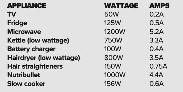

In the UK, this will generally be 16A. The basic formula to follow here is Volts (V) x Amps (A) = Watts (W) – so, staying at a UK site with 16A electric hook-up, this would be 230V x 16A = 3680W, meaning you would have a total of 3680W.
In contrast, if your site offers 10A hook-up, this drops to 2300W (230V x 10A = 2300W), while pitching up at a 6A site brings it down to 1380W (230V x 6A = 1380W).
Once you’ve worked out the total, you’re in a position to identify what you’re able to run simultaneously while pitched up.
As a rough guide, these are the typical wattages of a selection of appliances you could have:
