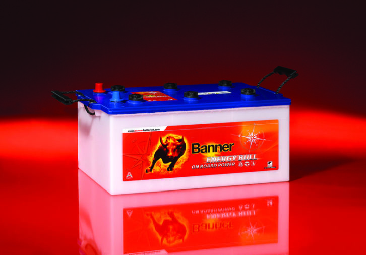

Flooded lead-acid
The most popular type of leisure battery is the flooded lead-acid, or FLA
The most popular type of leisure battery is the flooded lead-acid, or FLA.
These simple batteries get their name from the lead plates that are submerged in sulphuric acid inside the casing. The acid acts as the electrolyte, creating the electric charge.
Some of these batteries have removable plugs, which allow you to top up the battery with ionised water (never tap water or sulphuric acid), ensuring the plates are kept covered. You should do this at least annually.
Failure to do so can cause the battery to overheat. In extreme cases, they can become very hot and swollen, which is highly dangerous. If this happens, disconnect the charger and let the battery cool down.
Chances are, it is already damaged beyond repair, but this will be confirmed if, when topped up with ionised water, the voltage is below 11.9V.
Many modern FLA batteries are sealed, in which case, maintenance is not an option. All flooded batteries are at risk of leakage if they are tipped or tilted, and even sealed batteries have vents that can leak. Extreme care should be taken when removing or transporting these batteries.

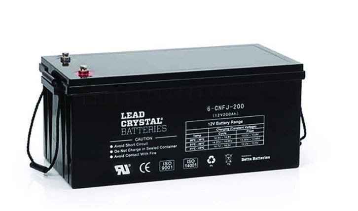

Lead-crystal
Lead-crystal battery
The electrolyte in lead-crystal batteries consists of a crystallised acid, sandwiched between the lead plates.
This non-leak technology is relatively new and costly, but does have the benefit of allowing very deep discharge, with no adverse effect on the cell. These batteries can also be recharged twice as quickly as a lead acid battery, and have a much longer life, off-setting the high purchase price.

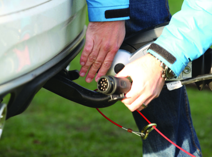

Battery charging
While your tow car engine is running, the leisure battery will be charged through this car-to-caravan power lead
Your leisure battery will be charged while your caravan is being towed, or when you are plugged into an electric hook-up point. It can also be charged when removed from the tourer.
A typical battery needs to be charged at 14.4V to achieve a 100% charge. However, many basic caravan electrical systems only provide 13.6-13.8V, because this won’t cause problems with overcharging or gassing (when the battery is fully charged and the continuing current turns water in the electrolyte into hydrogen and oxygen).
