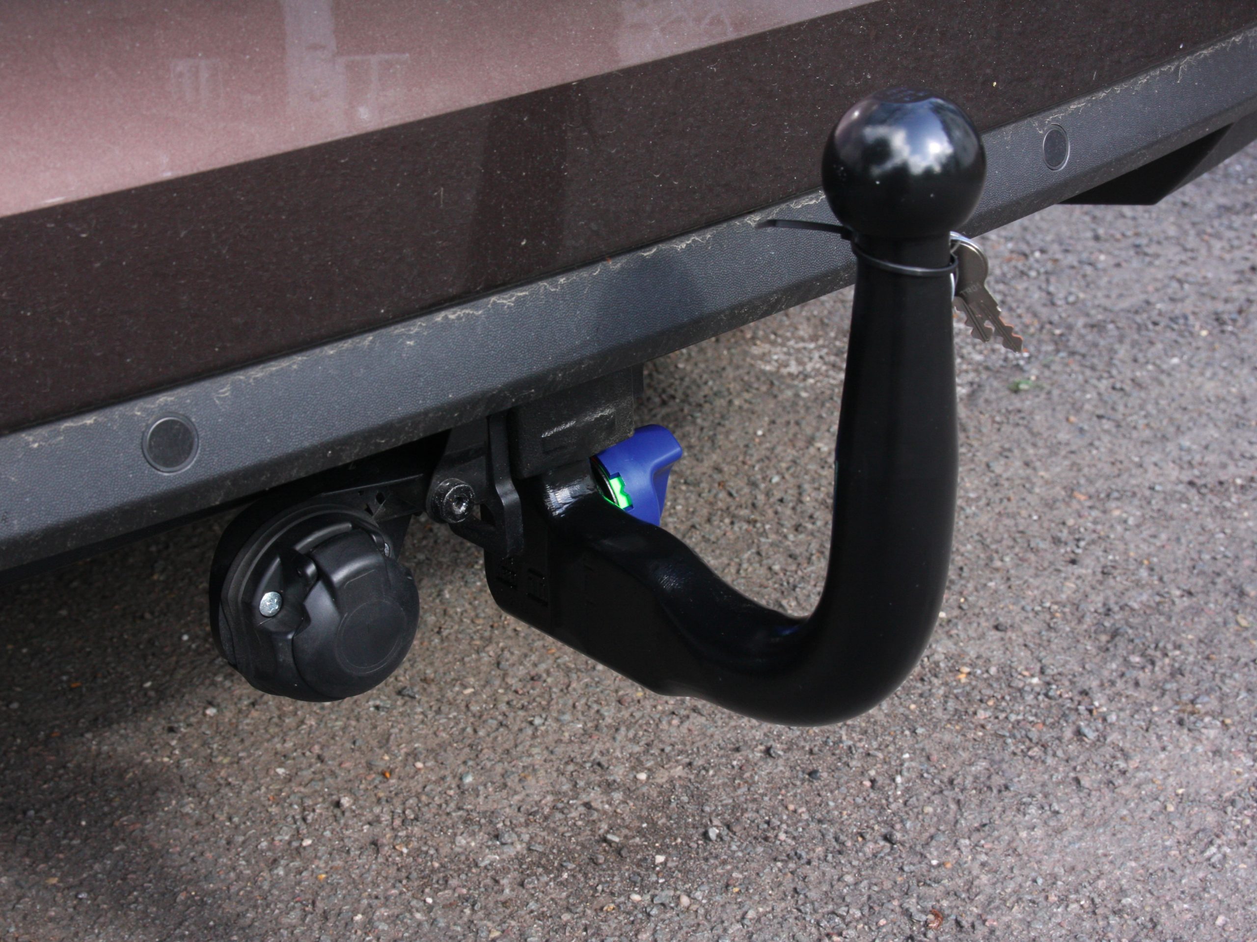

But what if you have a detachable tow ball?
In that case, you’ll probably encounter some form of attachment loop (as indeed you might on a fixed tow bar), but I have found that many of them are too small for the clip to pass through, so are practically useless for the standard breakaway cable.
That being the case, the official line is, “contact your tow bar manufacturer to see whether it’s acceptable to loop the cable around the detachable tow ball.”
The problem with looping the cable over a detachable tow ball is that should the tow ball drop out of its receiver while towing, then so will the cable, and the brakes will not be operated.

Recently, both my son and dad had new detachable tow bars fitted to their cars, and while both have loops for attaching a breakaway cable, these also aren’t big enough for a clip-type cable to pass through.
I’ve also had a look at a couple of fixed tow bars, and it’s a similar story there.
Which tow bar do you have?
With flange-type tow bars, there are aftermarket attachments you can fit, and in the Netherlands (where looping around the tow ball is prohibited), they sell clamp-on brackets that attach to their preferred swan-neck types, but I can’t remember seeing any available in the UK.

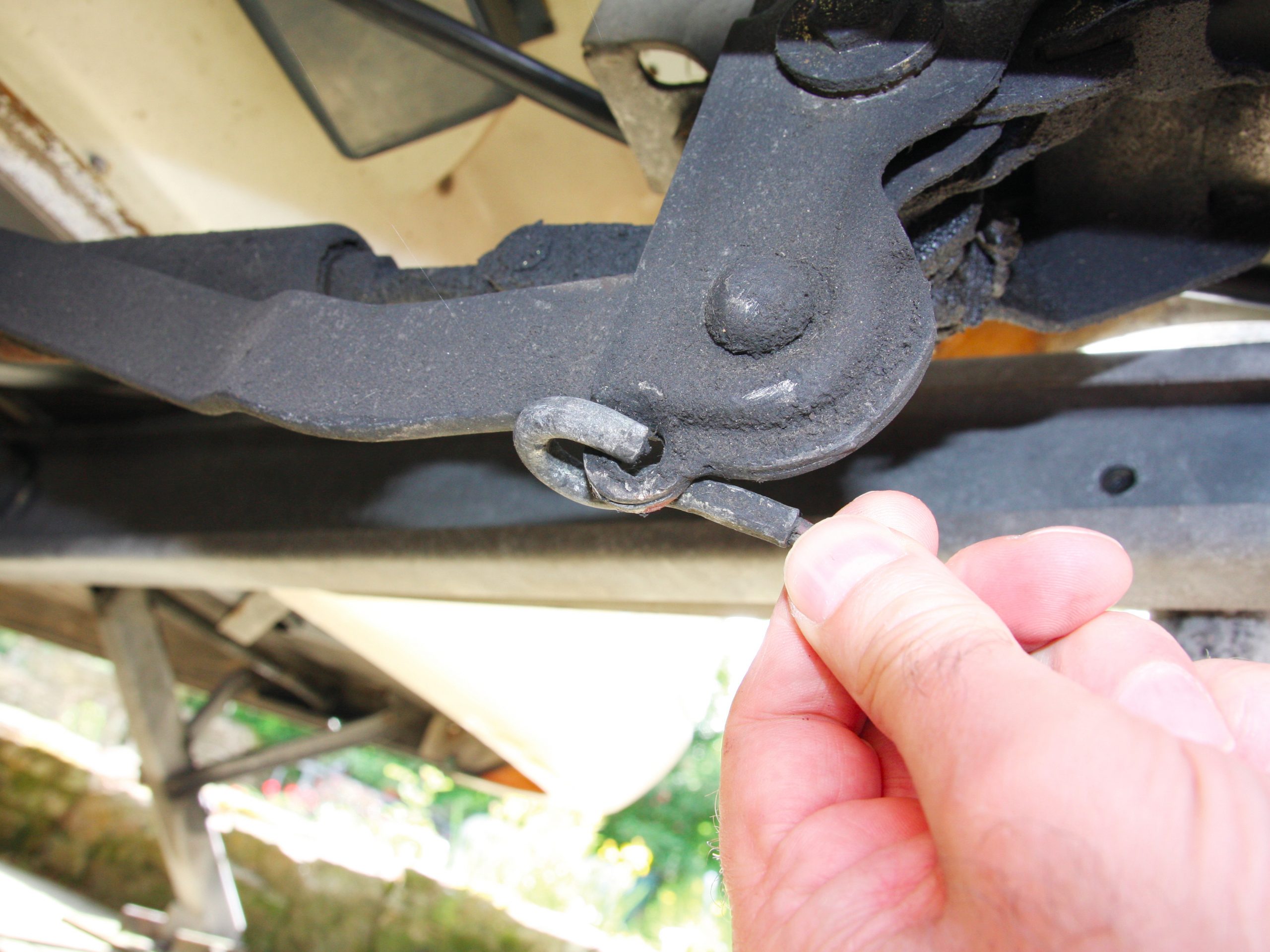

Having noted the routing, the hook that attaches the cable to the brake mechanism needs to be cut in half using the hacksaw. You can then remove the old cable.

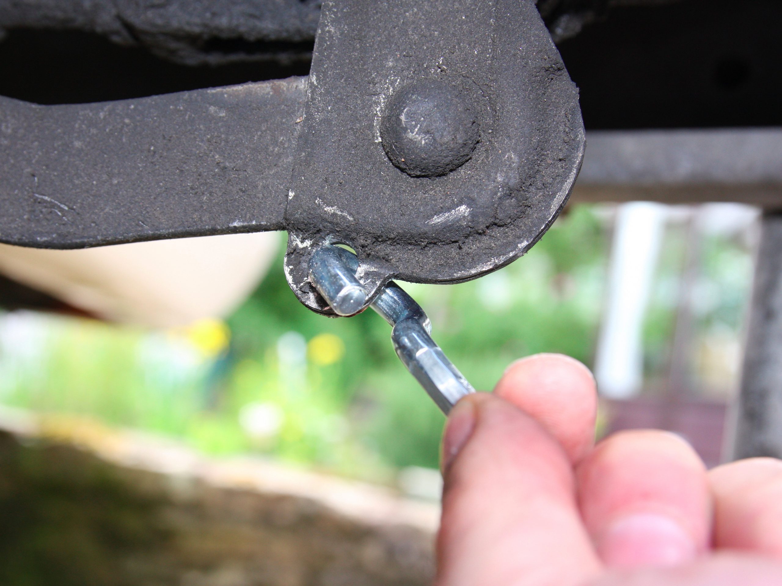

Starting from the front, feed the new cable (hook end first) back along the original route, and through any guides, then hook it into the ring in the brake mechanism.

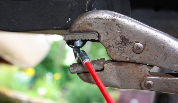

Then, in stages, gradually close the opening of the hook using the mole grips – doing this takes quite a bit of strength. Continue until the gap in the hook is almost closed.
