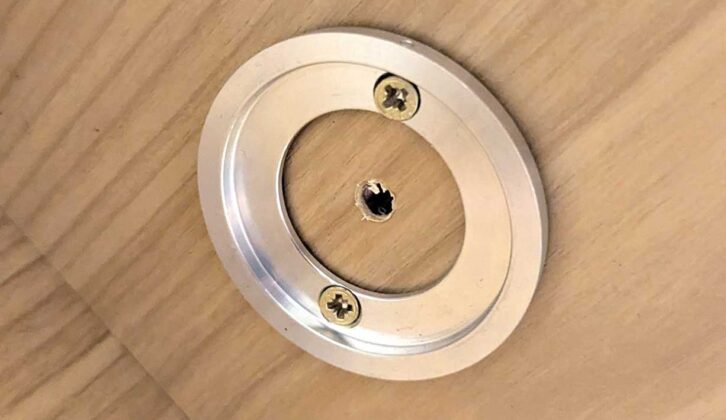

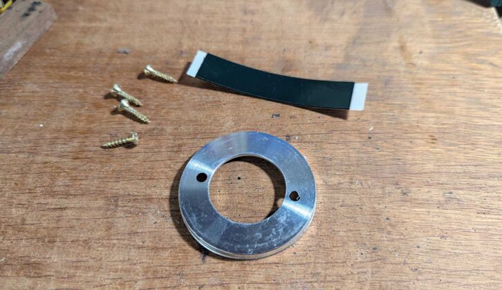

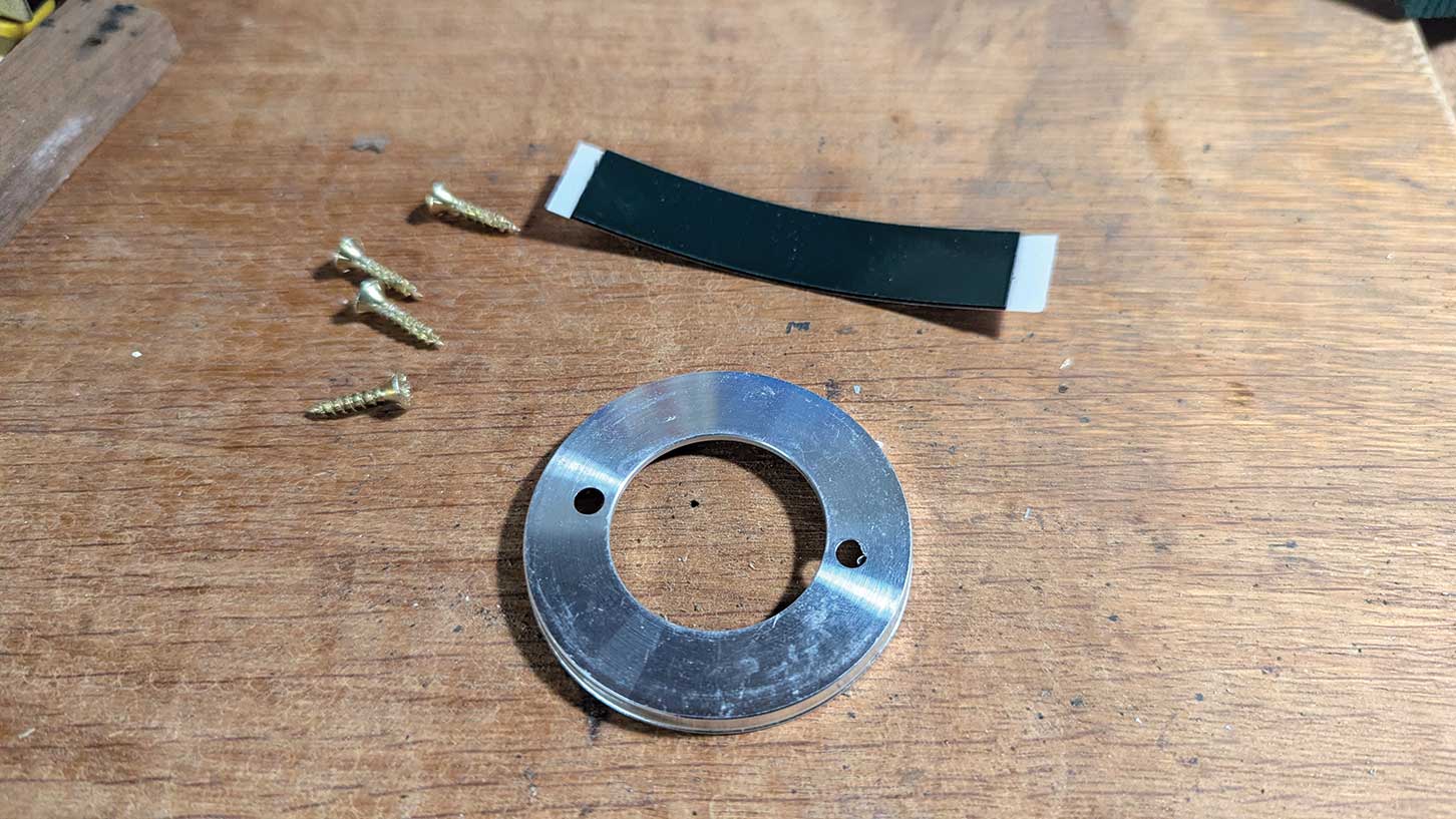

The sticky pad, screws and base plate
The new lamps are best placed with a sticky pad to get them perfectly located, before locking them in place with small woodscrews

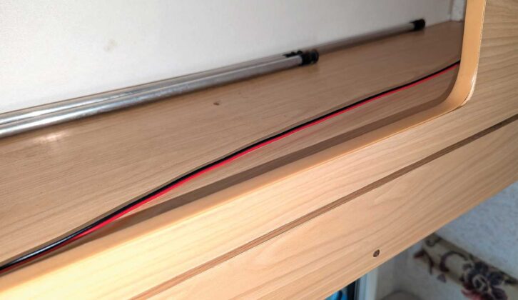

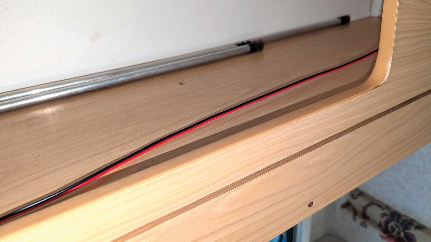

The cable running through the cabinets
Cable runs between the two new lights ran neatly through the cabinets
Ordinarily, the main doorway might have been an issue, but we’d already run cables across the doorway when upgrading the exterior light last year. We could get into the old conduit and run a cable across to the back of the van. Once the cable is in the rear lockers, it’s a simple matter of getting the cables through the locker bases to the light fittings, and neatly tucked out of the way.

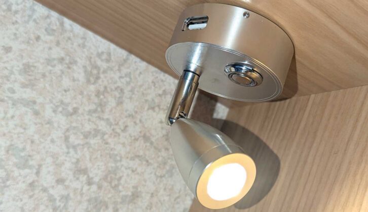

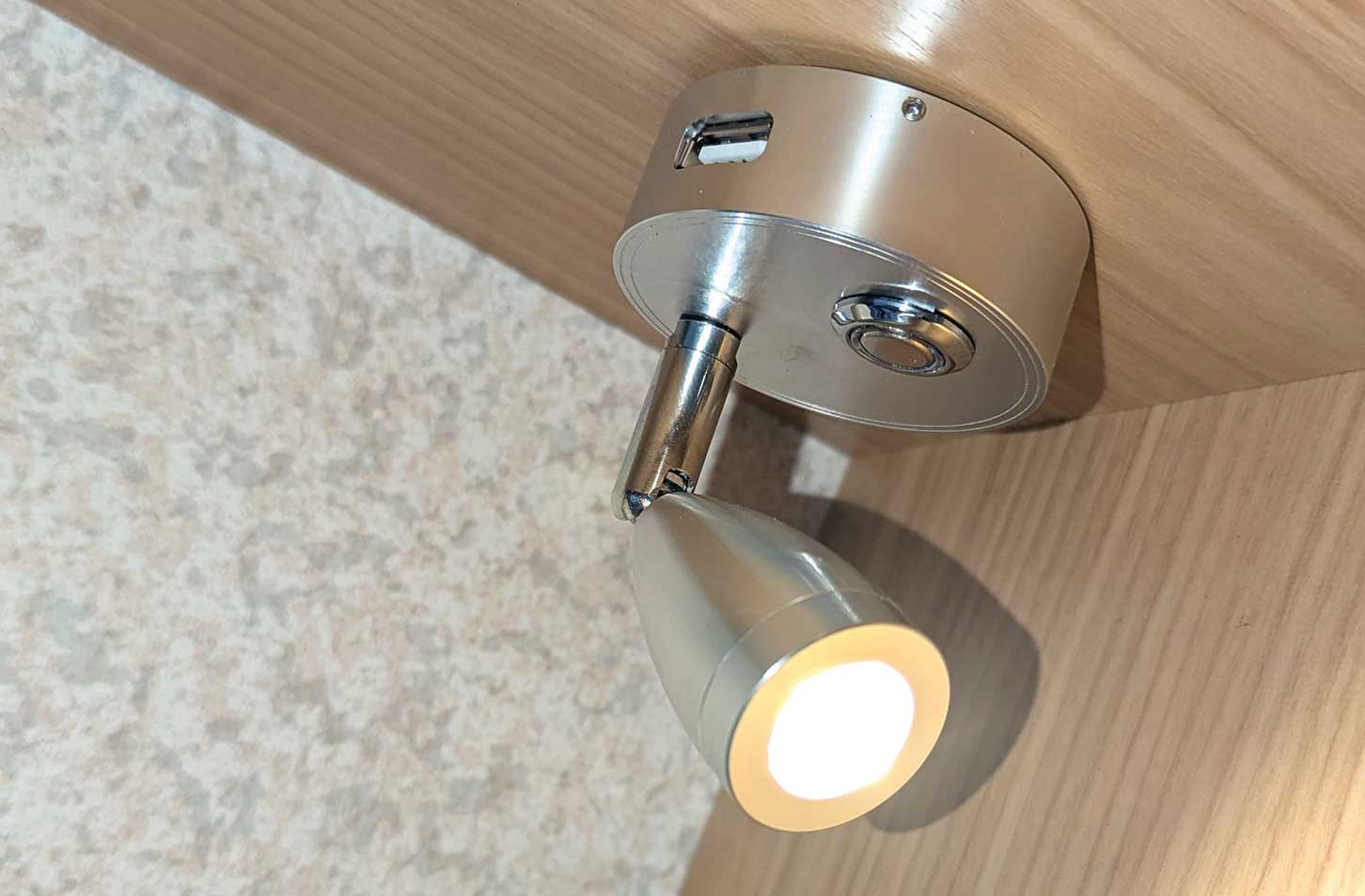

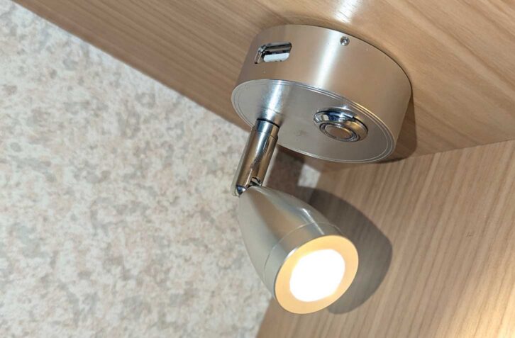

One of the LED lights switched on
The new lights have touch-sensitive controls. They are dimmable, have inbuilt USB-A charging sockets and are LED for low-power consumption

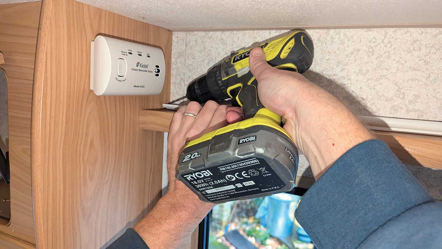

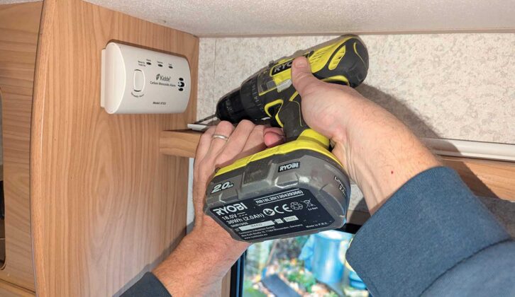

The final consideration is where to mount the lights. Penny has a bunk under the lockers at the back and we occasionally have stowaway nieces and nephews who use that bed, so we needed to get the new lights as far forward as possible. We worked out sensible positions for the lamps before we reached for the drill in our caravan tool kit to start drilling holes.

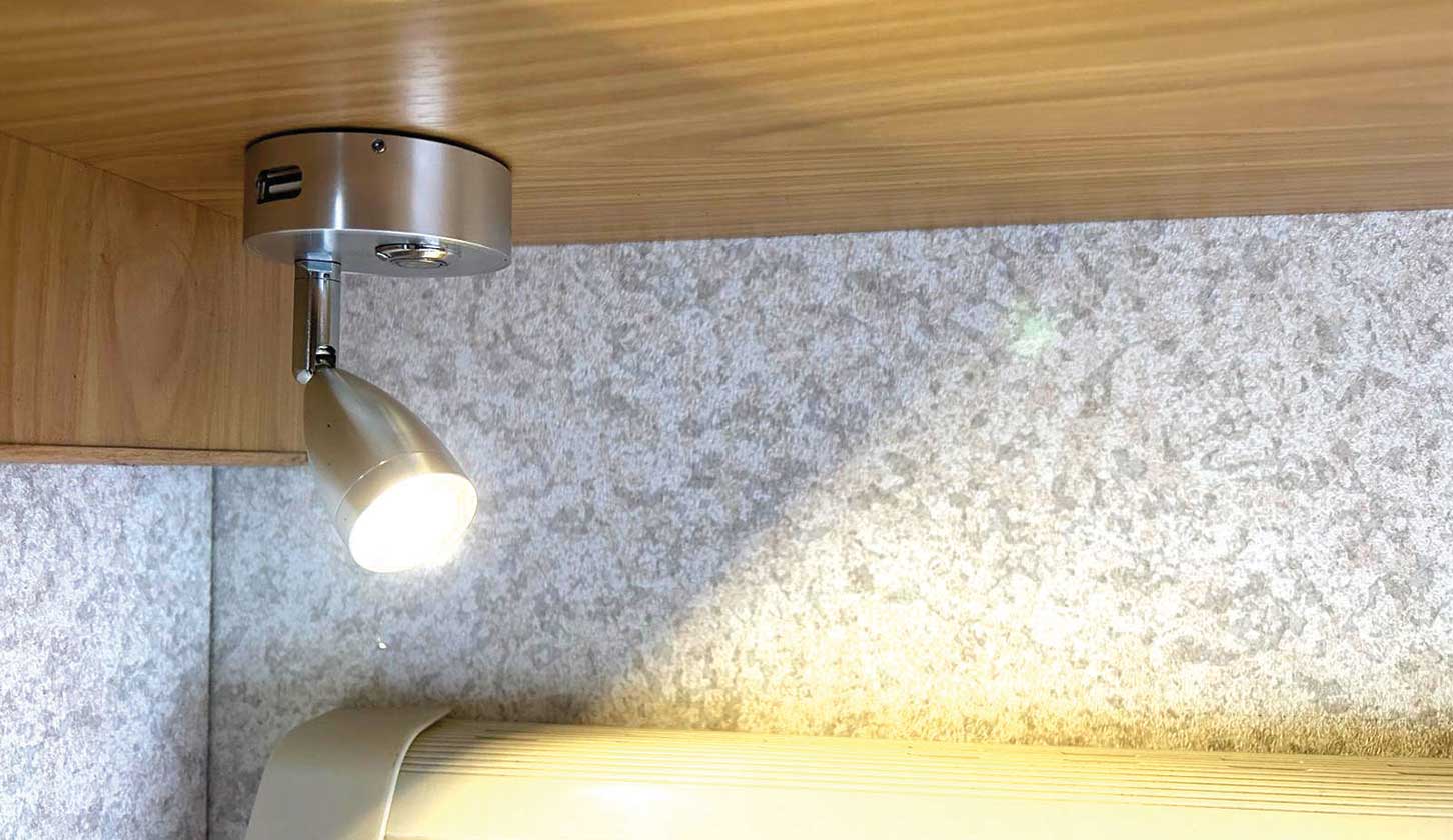

The final result
With the lights fitted and all the sawdust cleared up, we were pleased with the overall appearance of the new lights, but it wasn’t until it got dark we could see how well they worked. They are pretty bright, but we have found that by rotating the lenses towards the wall, you can diffuse the light and ensure that final glass of wine in the evening is a little more magical.

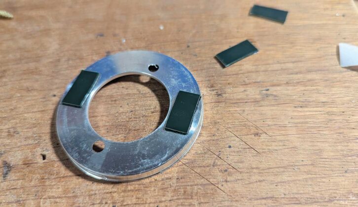

A heavy-duty sticky tab cut into pieces and stock to the base plate
We cut a heavy-duty sticky tab into tiny pieces and stuck them to the base plate

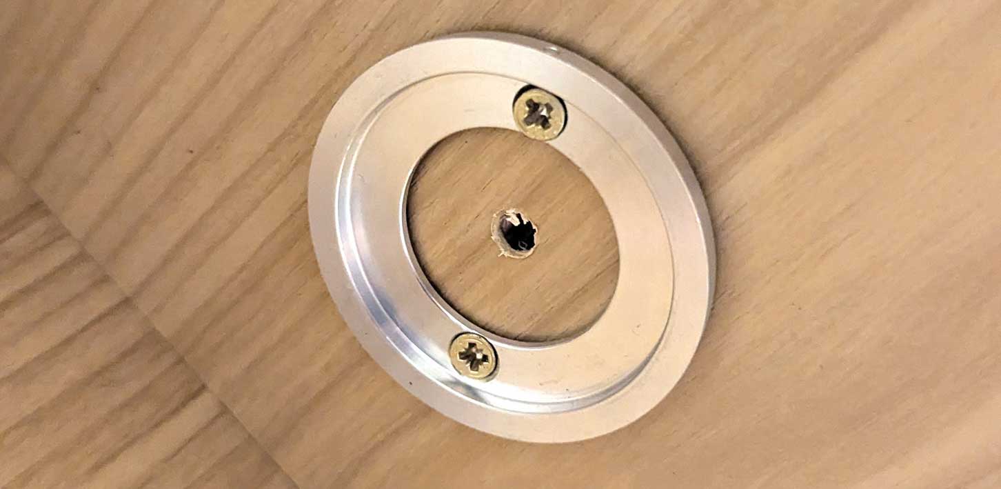

The base plate in place
We centred the base plate over the hole we had drilled for the spotlight cables, stuck it in place and then sited it permanently with small wood screws

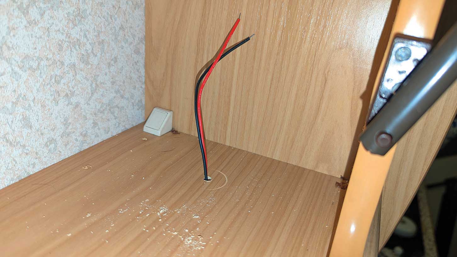

The lamp cables running through the holes
Once the base plates were in place, we ran the lamp cables through the holes and into the cabinets
Drilling one of the small holes
The actual cabling is very simple, but the main effort is in getting them into the right places. We ended up drilling small holes to run the cables between cabinets

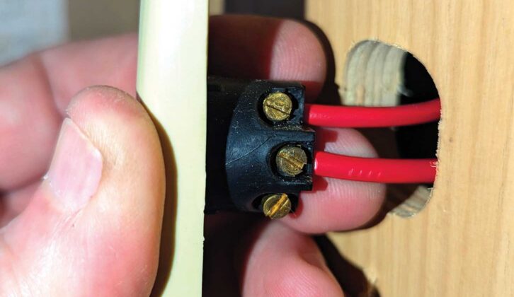

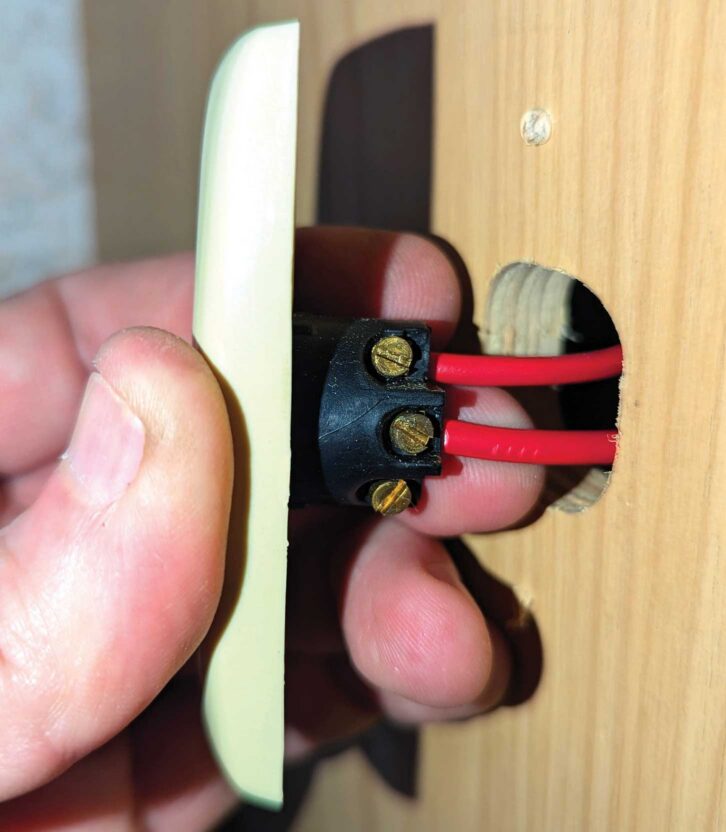

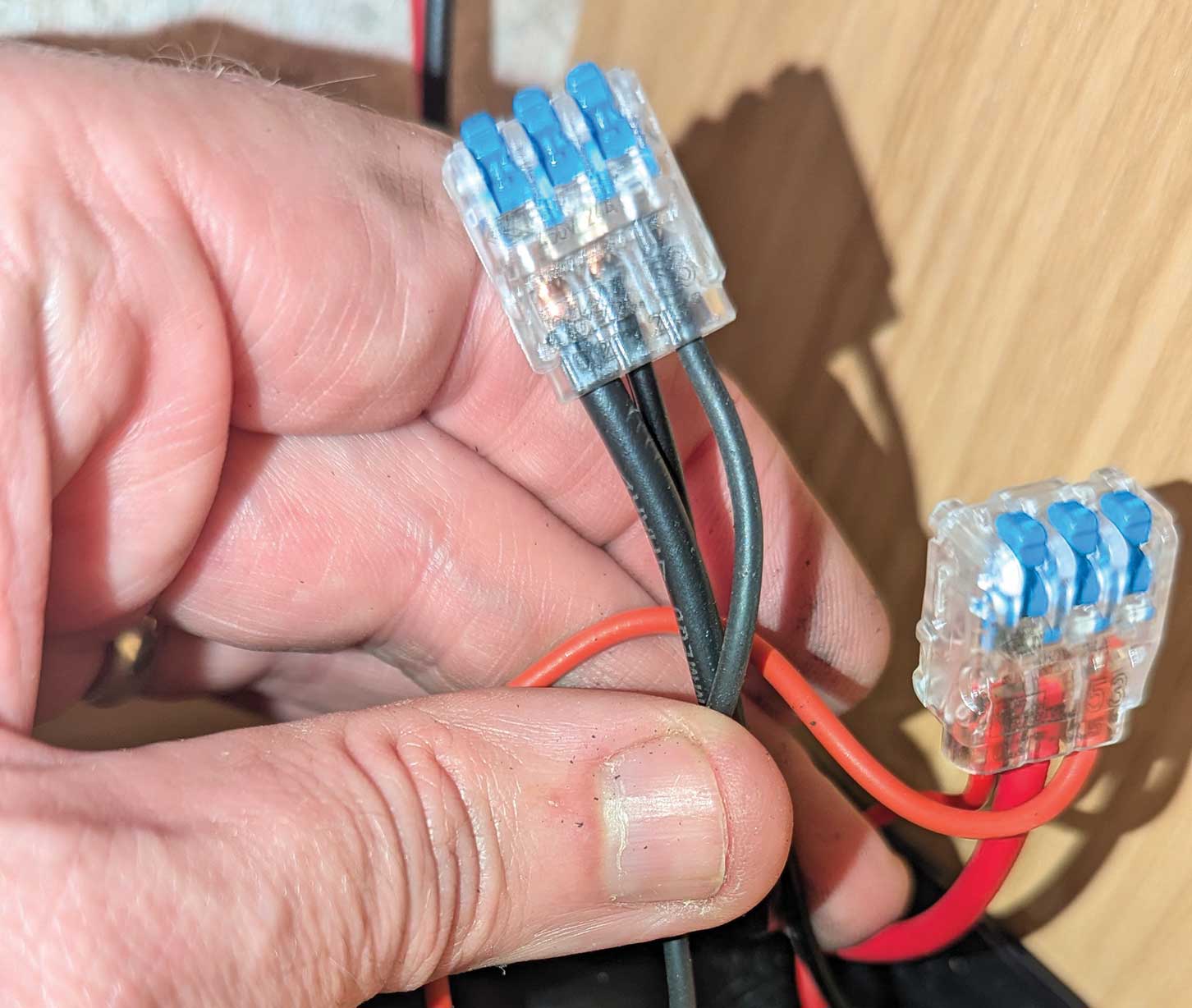

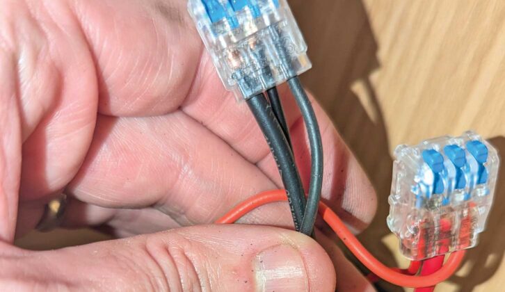

The lever nut or 'Wago' style connectors
Electrical connections were kept simple and reliable by using lever nut or ‘Wago’ style connectors
Connecting the lights to the original circuit
We connected the new lights to the original light wiring circuit
